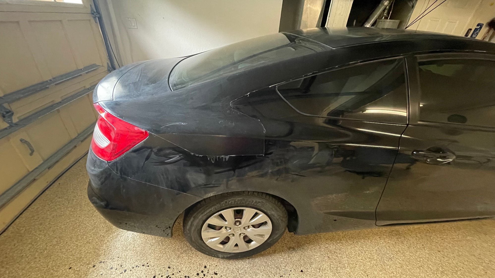

Yeah, I considered just listing it and seeing what people would offer but, I’m wary of people who might over low ball me based on my lack of knowledge. This picture is of the worst side. The other side is also affected but this side is bad. There is some dust (that I shoild have wiped off before taking the picture) but; you can see the stark difference between original paint, which is in good condition and the shitty job that was done over it.
edit* her idea was to do a fine sand job over this first attempt and then apply clear coat. Am I underestimating my wife’s plan?

woah.
yeah, fine grit sand some and clear coat...
9th gen car? (2012-2015) not familiar with the newer ones to reckon quickly

Start with 300-400 grit, then some 600, and then the clear. Do good prep work, clean the area with rubbing alcohol or prep solution, and mask off the areas you're not painting

Id advise not to do anything unless you plan on finishing it perfect. Because if the body and paint arent 100% smooth, it will show especially because the car is black. Also you have a strong line that you have to sand down and blend that paint. Not for the amateurs.
If you cant get it perfect you wont gain any value to the car. You'll be lucky to get 4500 because of that paint.
But if you DO plan on trying to get it perfect, then Colin is right, look for Chris fix video. You spend practically pennies for what you would gain in value.
