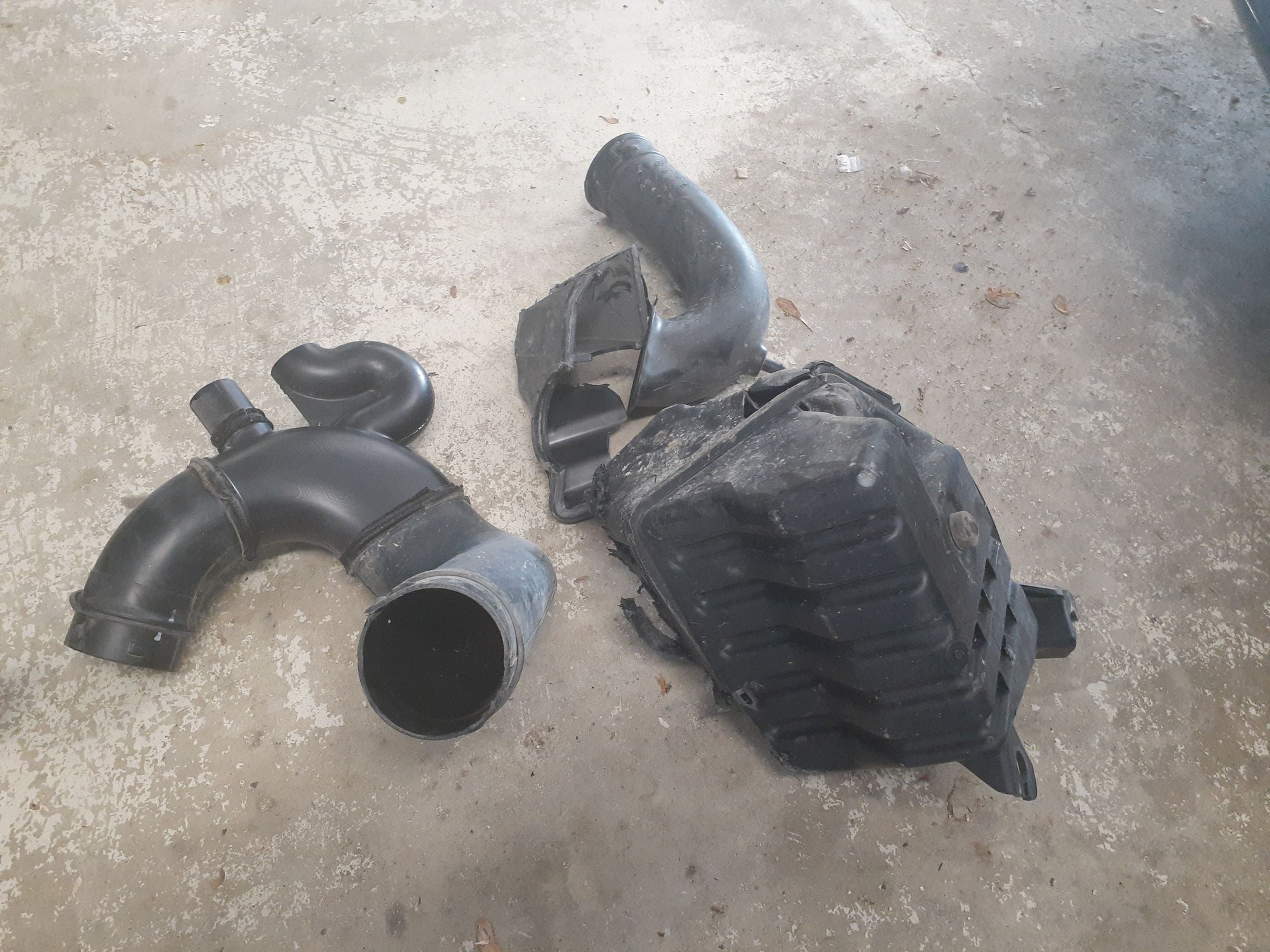

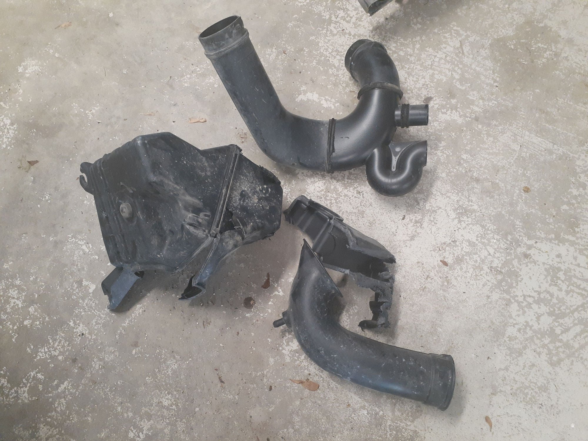

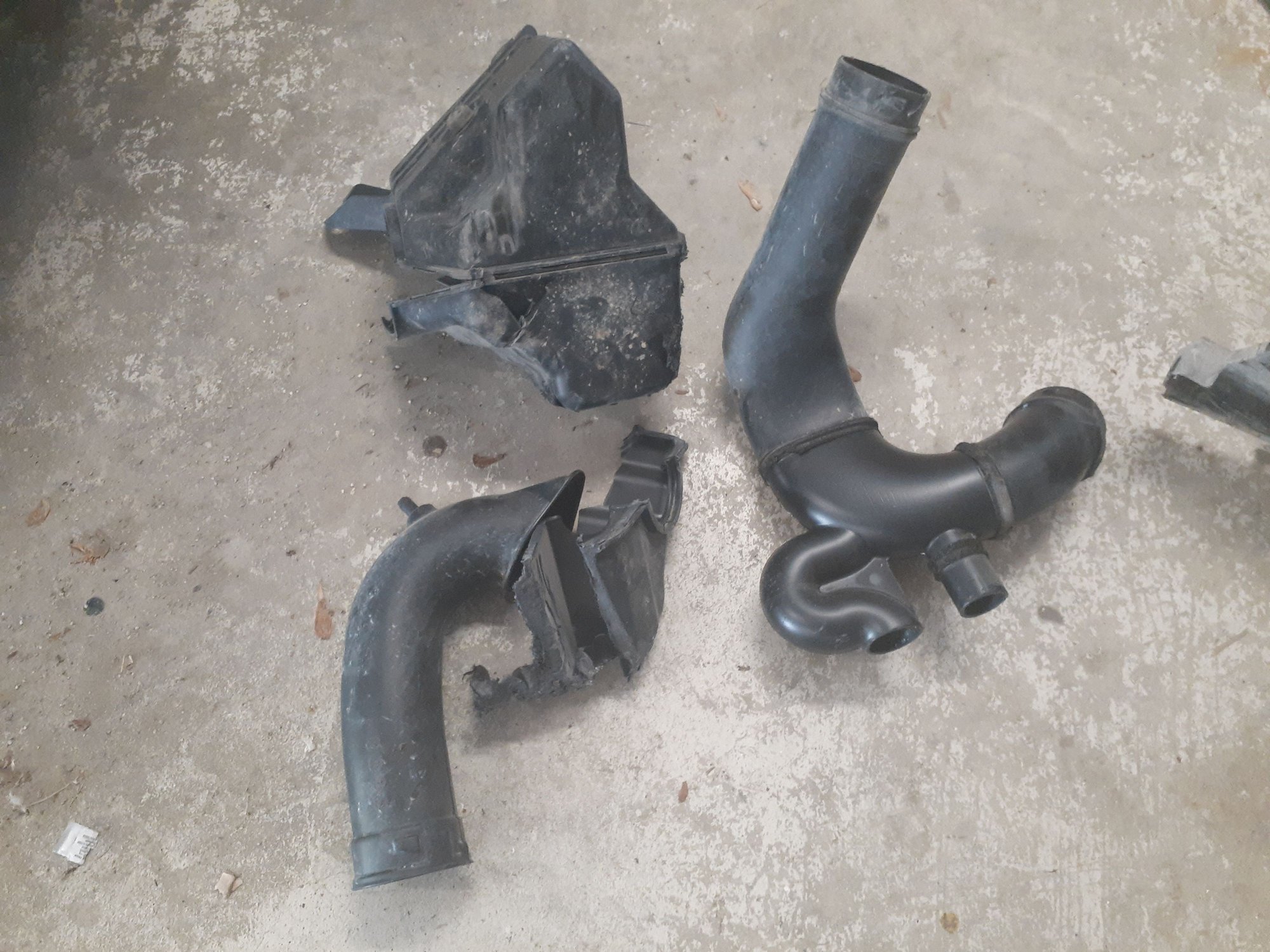

That appears to be it(I'm attaching photos of the broken parts just to cover all bases, though). How much priority should I put on replacing this? I know the resonator isn't JUST about reducing noise, but I see a lot of conflicting info on how important it is to replace if it gets busted.

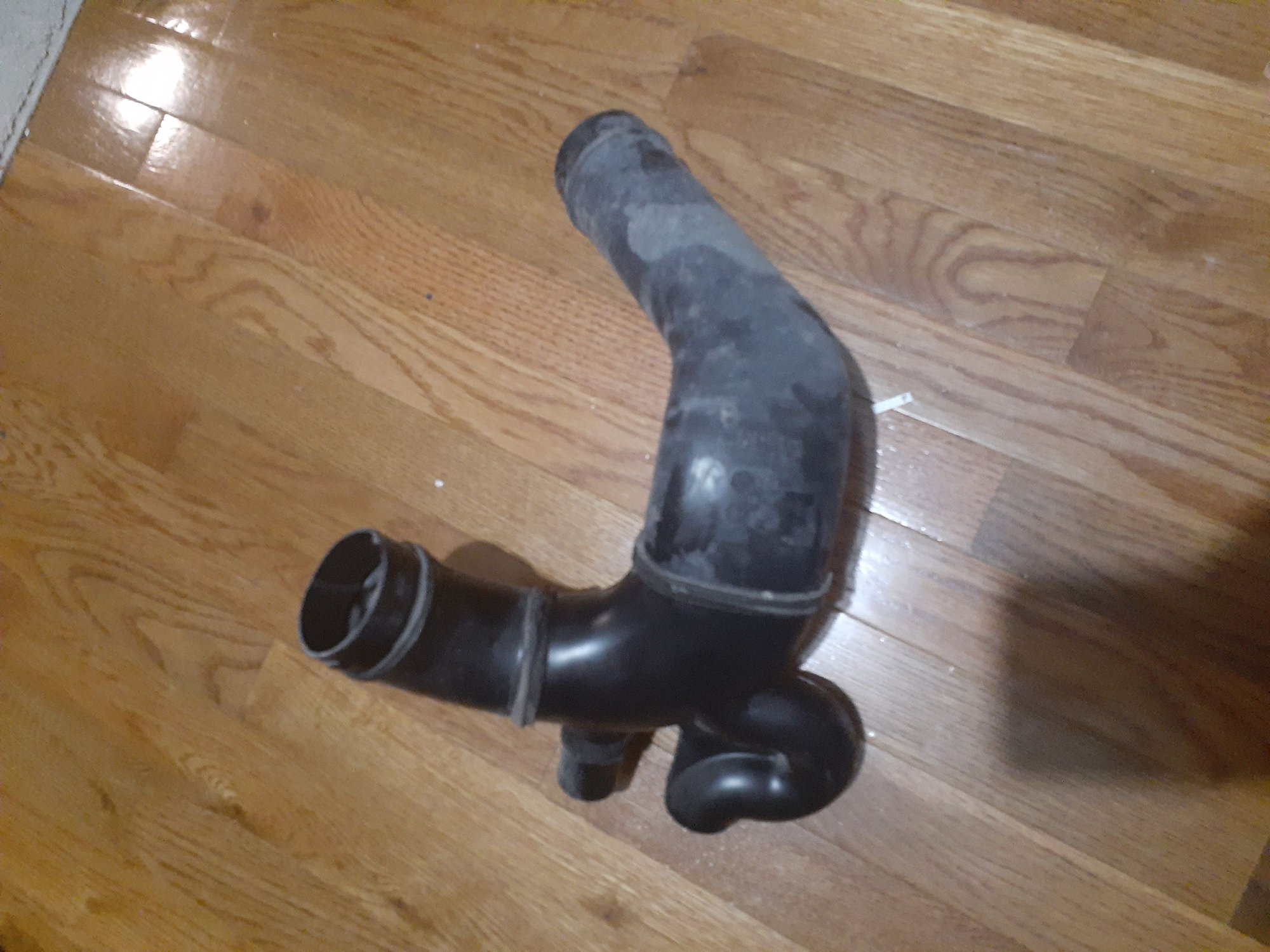

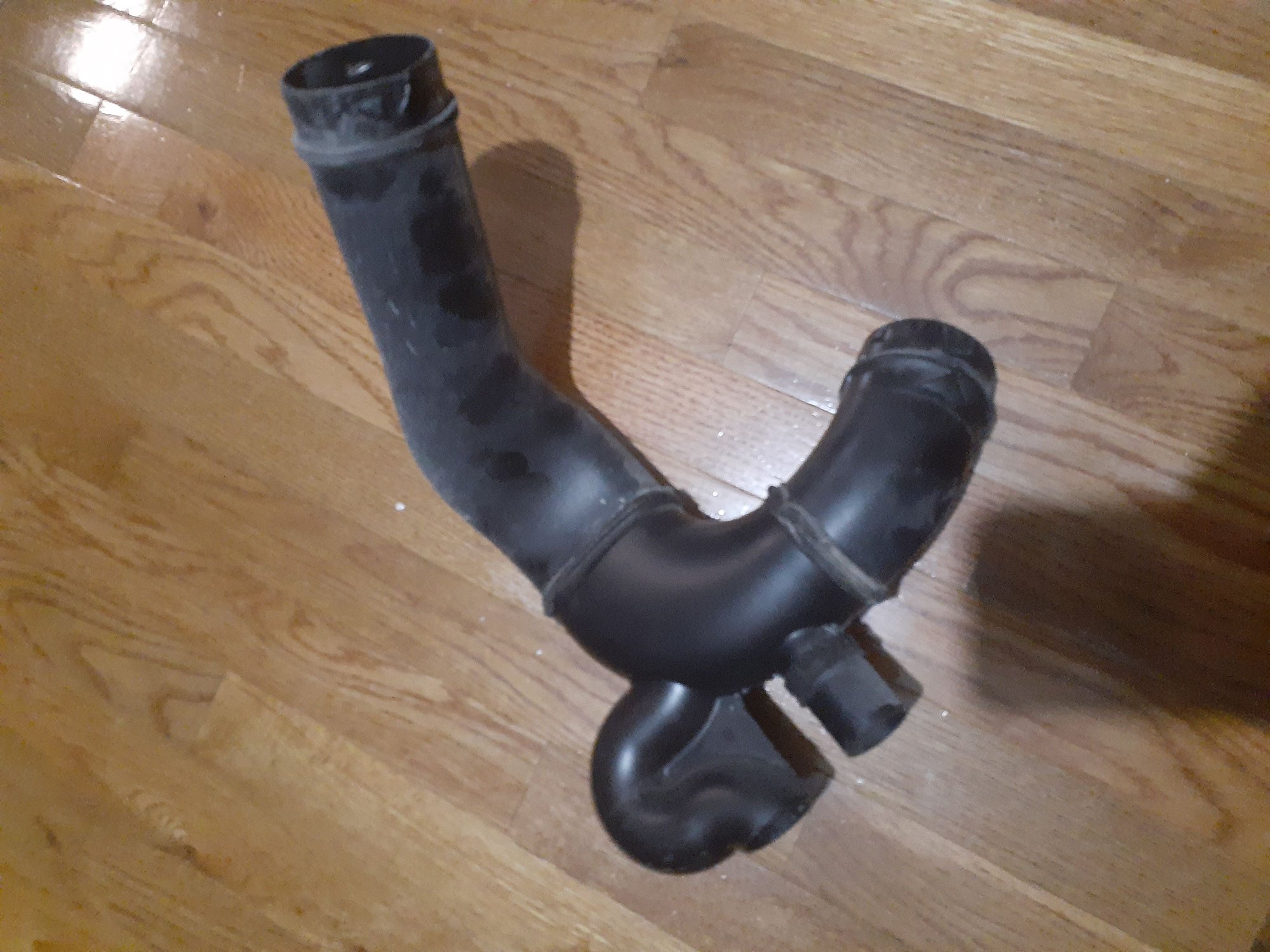

So....got another issue.... I was looking over the diagram for the resonator box assembly and noticed that one of the pipes is NOT shown amongst any of the parts in the link. I've no idea what it connects to as we have not yet jacked up the car to work on and really look at(that comes tomorrow - I have tonight off), but in the meantime I'd like some info on where to look for potential damage from this coming out. I've obviously attached photos.
This piping appear to be undamaged as far as I can tell, and I cannot find a part number on it.

TBH, resonator isn't quite a vital part. If you don't install it, you'll have a little more engine noise, really about it. Maybe a slightly higher intake air temp since air suction source will be deeper inside the engine bay.
as far as that missing part. No lie, if you look at the entire assembly #7 in the diagram, that missing pipe looks like it snapped off from inside the chamber. The broken plastic box doesn't have the pipes sticking out of it, and the angles of the "pipe missing from the diagram" kinda match the pipes sticking out of the box in the diagram.
You called it - as soon as I saw your post I went out to check, took me two seconds to find how it fit inside. And now I'm actually thinking it may be possible to piece this back together - if I can find a way to completely seal the box it should work mostly like before - at the very least will provide the potentially cooler air by taking it in further from the engine. It's a question of whether or not it's mounts are broken at that point - need to take a close look at it once it's back in shape. I'm always up for saving a few bucks on parts that won't make the car blow up when you go cheap, so if I can make this work, that's a pretty big benefit.
If I can't piece the box back together, I can at least put that section of piping back in so that the car will get cooler air.

The box is not fixable - it's too far bent out of shape to be bent back into it's proper shape without some very specific heat treating that is beyond my capabilities. I've put the piping back in place so the engine will at least get cooler air and I can worry about replacing the box itself something down the road. Car is now back together with no visible evidence anything ever happened.
