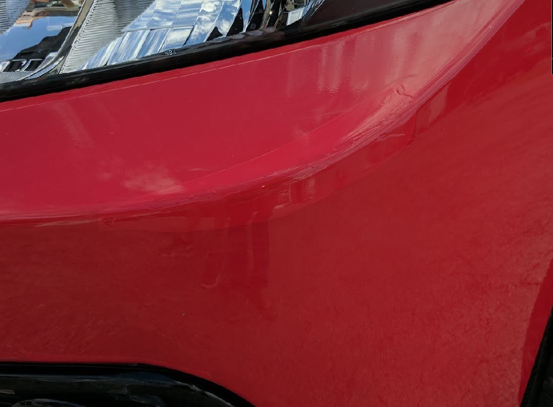

any sign shops by you?
i'd smooth the deep scrapes, spray that tiny area with whatever paint you have lying around, and slap a closely matching silver vinyl over it. i may be biased. i own a sign shop. people like you stop by sometimes and i usually don't even charge for vinyl scraps that small.
most of the silver vinyls i use are rated 7-9 year outdoor durable. i probably have at least 5 or 6 shades to pick from lying around
my last 5 minute vinyl repair:
