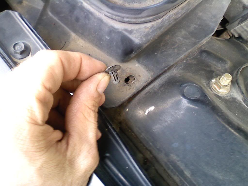

btw- body pins are little plastic pins that look like this (as you see, I ruined mine getting it out. lol):
