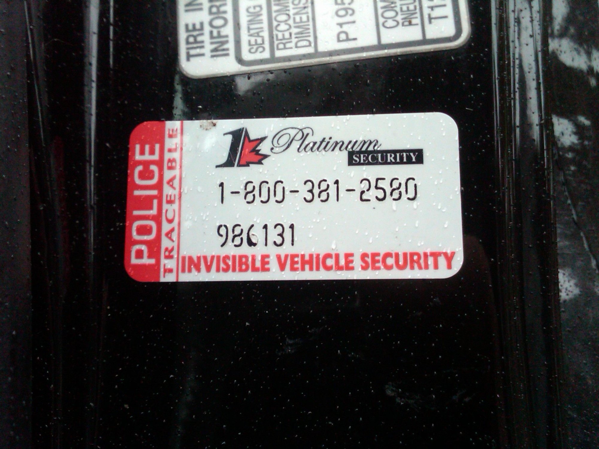

Hey all ... I took a quick look here under 'DIY - Electronics' and don't think my failure to be able to get my car into key/fob (re-)programming mode is related to any 'Immobilizer' functionality (FYI - this car does have stylized "Platinum SECURITY" labels [they look 3rd party / not Honda] added to most every body opening on the car, so, the car may have had some alarm system mod prior to my ownership ... could this be an issue?).

Colin42 ... ... just these labels at most every body opening ...
I called the 800 # on the label some time (years?) ago and was unable to obtain any information about the 986131 # on the label or what the company / label / # represented ... if I recall correctly, apparently this alarm service (if that's what it was) was no longer monitored / current / in existence. FFF
