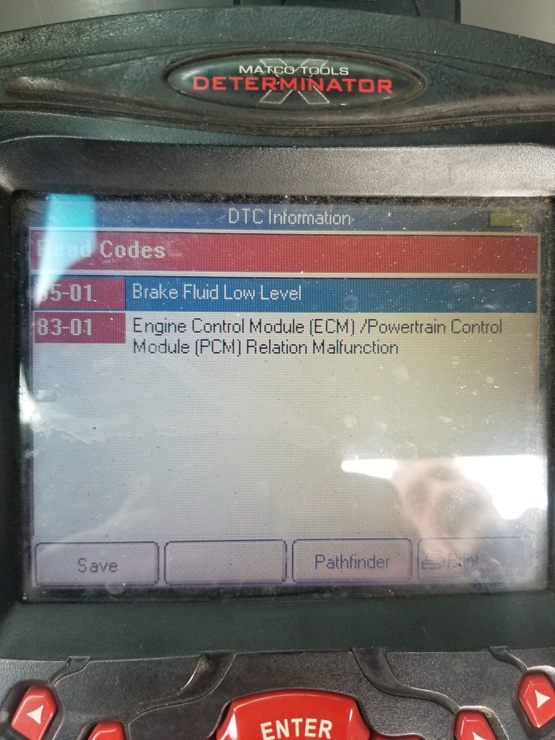

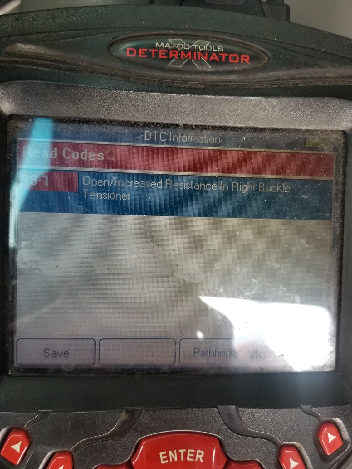

My mechanic found out the codes for me with a code reader. He was able to find the explanations as seen in the pics. I am still a bit confused...could this still be a problem with the system even though the light on the display has gone out?
