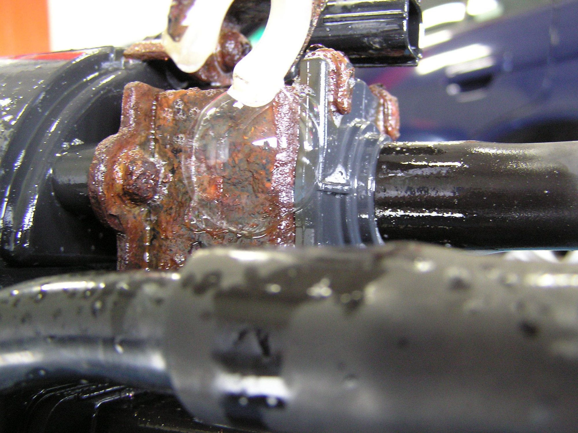

Thanks NDNV. Do you have a picture or part# for that bypass shut valve?. I did a pressure test at the back end, and the canister, tank, filler hose all seemed to hold pressure. I also checked and tested the purge valve, and that was fine. I guess now I need to confirm that the vent valve is getting closed by the computer.
Old Nov 13, 2018
Re: Another P1457
Rusty CVS valve failing leak test @ 1PSI pressure:

yup...thats pretty much exactly what mine looked like when i had P1457
i was lucky and managed to get the screws out by grabbing then with a small pair of vice grips
