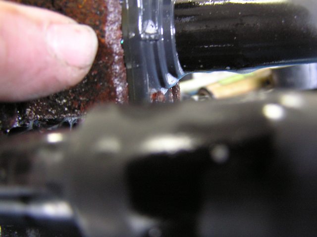

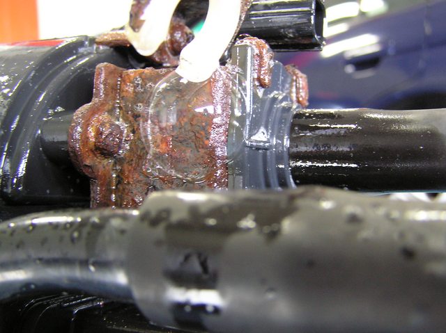

Hey just for laughs, here's pics of a CVS valve that's rusted bad enough to leak out the seams:
This was done with about 1 PSI regulated pressure on the system and spraying DAWN dishsoap mix all over to leak check with bubbles.
