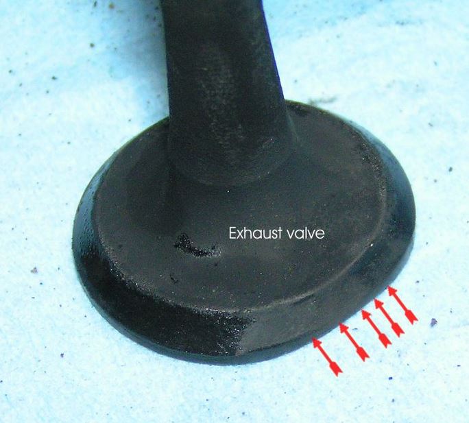

FWIW, and I can't say this is what happened but I know it's certainly possible:
If the head is removed and set face down flat on a hard surface (or maybe inadvertently banged while removing it from the engine), any valves that are open can be bent. There are always a few valves open on one cylinder or another.
Case in point, this head is from a D17 engine, it's timed at #1 TDC--check the open valves for the middle cylinders

Hi. "king of breaking stuff" here... when i was younger and dumber, i burned valves from setting the lash too tight. it will look like the attached image when it starts to happen. if you use hot lash measurements on a cold engine, the valves grow when they are up to temp, stick slightly open, and the valves can erode/melt away
i have a question. i have not had a honda engine apart since a D16 back in the day. if memory serves me correctly, a DOHC motor requires the cams to be removed, and then all the valves are closed(meaning the damage wasn't from setting the head down). is this motor SOHC or DOHC?
