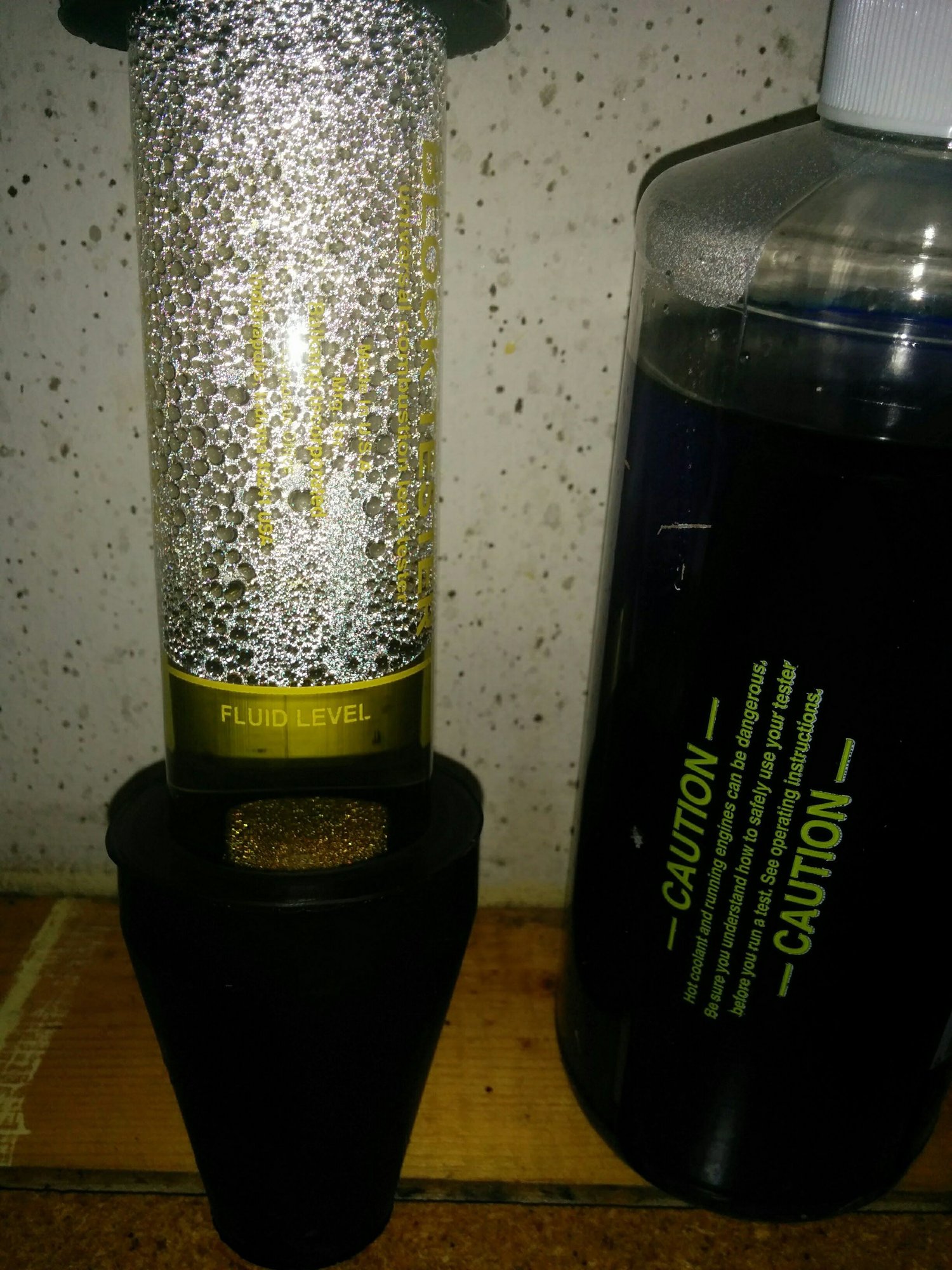

Here's my test tube, and the original blue liquid:

Originally Posted by mwrohde
Thanks for the reply.I could see the top of the coils, or cores, or cords, or whatever they are when looking down through where the cap was. Coolant was low. I had also just changed the thermostat and not refilled. After this test I added nearly a quart of water.
To note: even being a quart low and /or air in system can cause an overheat so avoid that situation. You should have filled the coolant system and bled it of air after thermostat replacement regardless of block testing.We all make mistakes so please don't take that harshly.
I suggest you fill up the coolant system, bleed it of air, drop coolant a bit and do another block test on it. Or disconnect the overflow that attaches to the reservoir from the radiator and test as shown in video below to ensure you did the test correctly. Even so, by your description below of symptoms it's very likely a head gasket breach.
How could you get a false positive? Where else could CO be coming from in the radiator?
A false positive can happen if coolant fluid (not vapors) mixed with the test fluid. It should say that on the directions. Green coolant dye + Blue test dye equals yellow. Retest drawing in coolant system vapors only.
