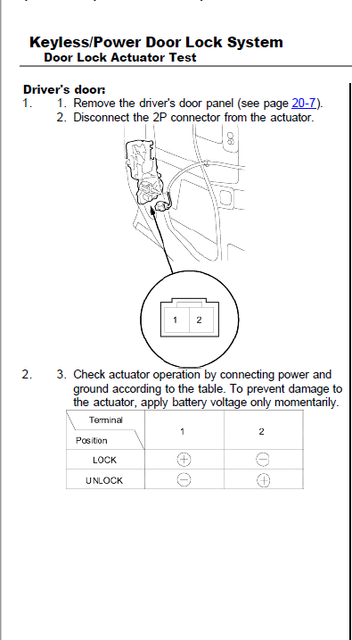

Here's a test for the switch at the door to see if it is working like it should you will need a multimeter to test for continuity.
And also a power test for the actuator since you said you have a power probe you can do this one easily.
