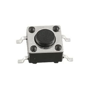

Alternative to putting in a parallel switch, what I did was physically replace the switch on my cluster. I used an old tactile momentary NO switch (sourced from an old DLP big screen, I'm sure you can find a bunch on ebay for cheap). Figured out which pins on the old switch and new switch were the negative and positive terminals. Desoldered the old switch, soldered in the new one, called it a day. This procedure did, however, require me to remove the fuel gauge needle, but as long as you mark where it was when the car is on, you'll be fine. My trip reset button works like day 1 with my car again, with a bit more of a tactile feel, since the original switch uses a capacitive backing on a rubber.. nipple.. thing.. to make contact.
Edit: the switch I used is quite similar to this one
All I did was google "smd tactile pushbutton switch"
If you decide to go this route, a few things:
1) I'm not responsible if you mess something up
2) make sure it's a momentary NO (normally open) switch. The one I used measures ~6mm x 6mm. It fit fine, IIRC, maybe just a bit of bending of the pins to make the sit nicely
