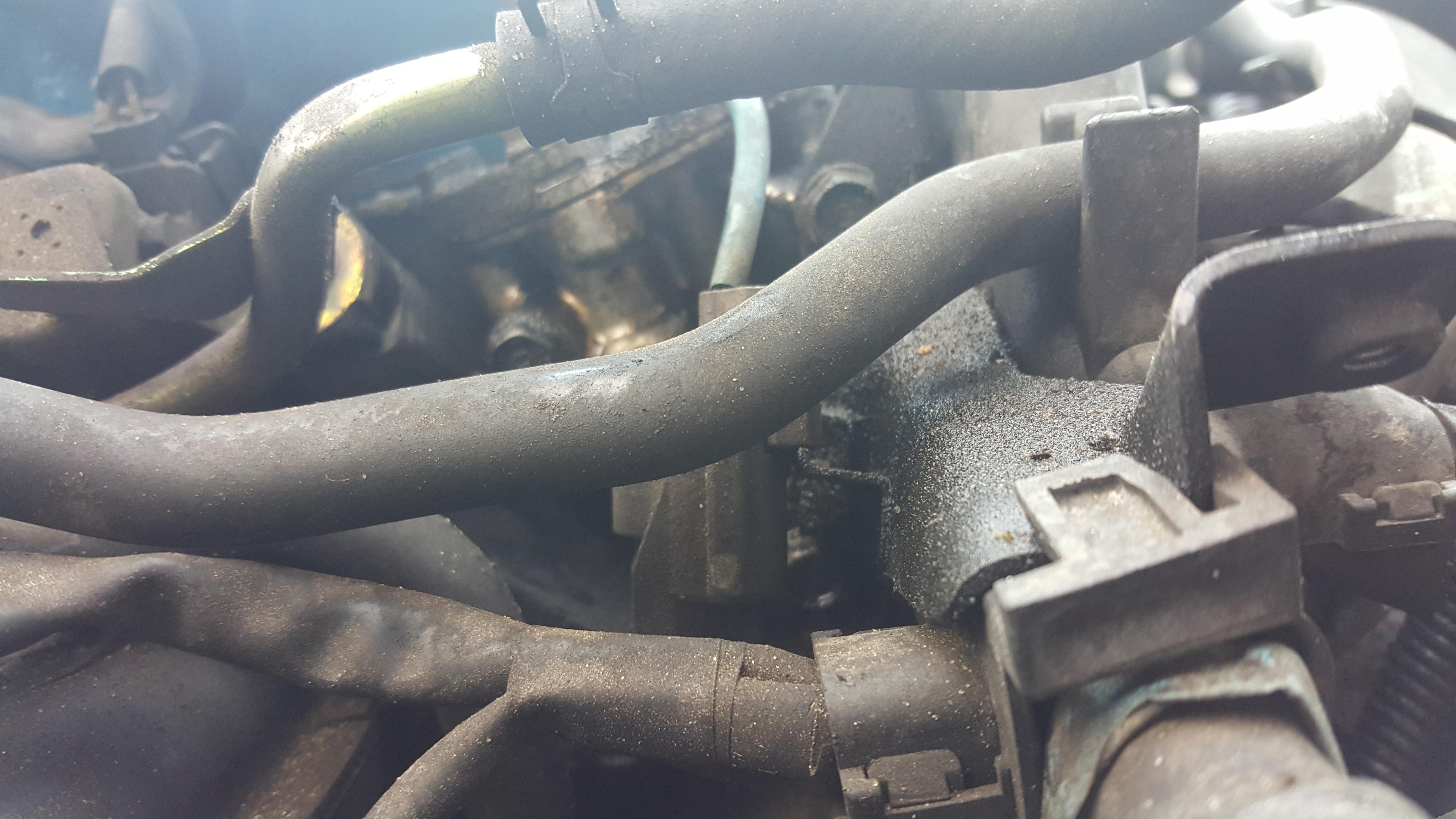

I have a 2003 honda civic ex with the d17 a2 226000 miles parked last night ran fine it has had a small leak arround valve cover but was only losimg a quarter of a quart ever couple weeks but went this mornimg to the doctor which was about an hour drive and when i was on my way home one of the doctors called me which i missed ans they had left a voicemail telling me i left a long trail and large puddle of oil leaving so when i get home there is oil everywhere! Was sprayed all over exhaust and dipstick had no oil on it when i got home i put oil in it but then it didmt leaked so i started the car snd saw it rush out the top below the valve cover right below the injectors i know its not the valcover gasket i took a picture of where its coming from any ideas? The leak is right below the blue wire

Can't tell what is in the first pic....
2nd looks like the VTEC solenoid needs fresh gaskets?
Honda part numbers:
Upper gasket# 36172-P08-015
Lower gasket with filter screen# 15825-P2M-005
