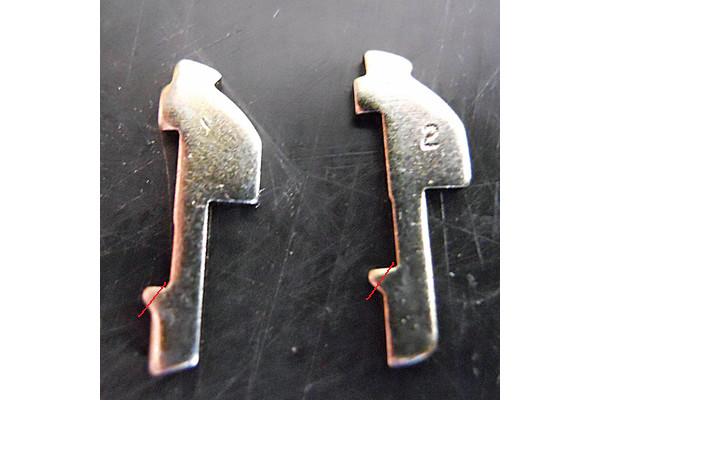

A friend of mine with experience as a locksmith assures me it will be no problem.I hope he's right.
Send him this pic and see if he has these, this pic is a couple wafers (tumblers) for a Honda Sidewinder lock.
The red lines drawn are where one will find the wear that causes them to jam up.
There's one other style (much larger) wafer in the lock but these above are the ones that cause all the problems.

You are correct sir.I pulled it apart and the number three wafer was bad.I removed them and the springs.Put it back together on the bench and seems fine.
