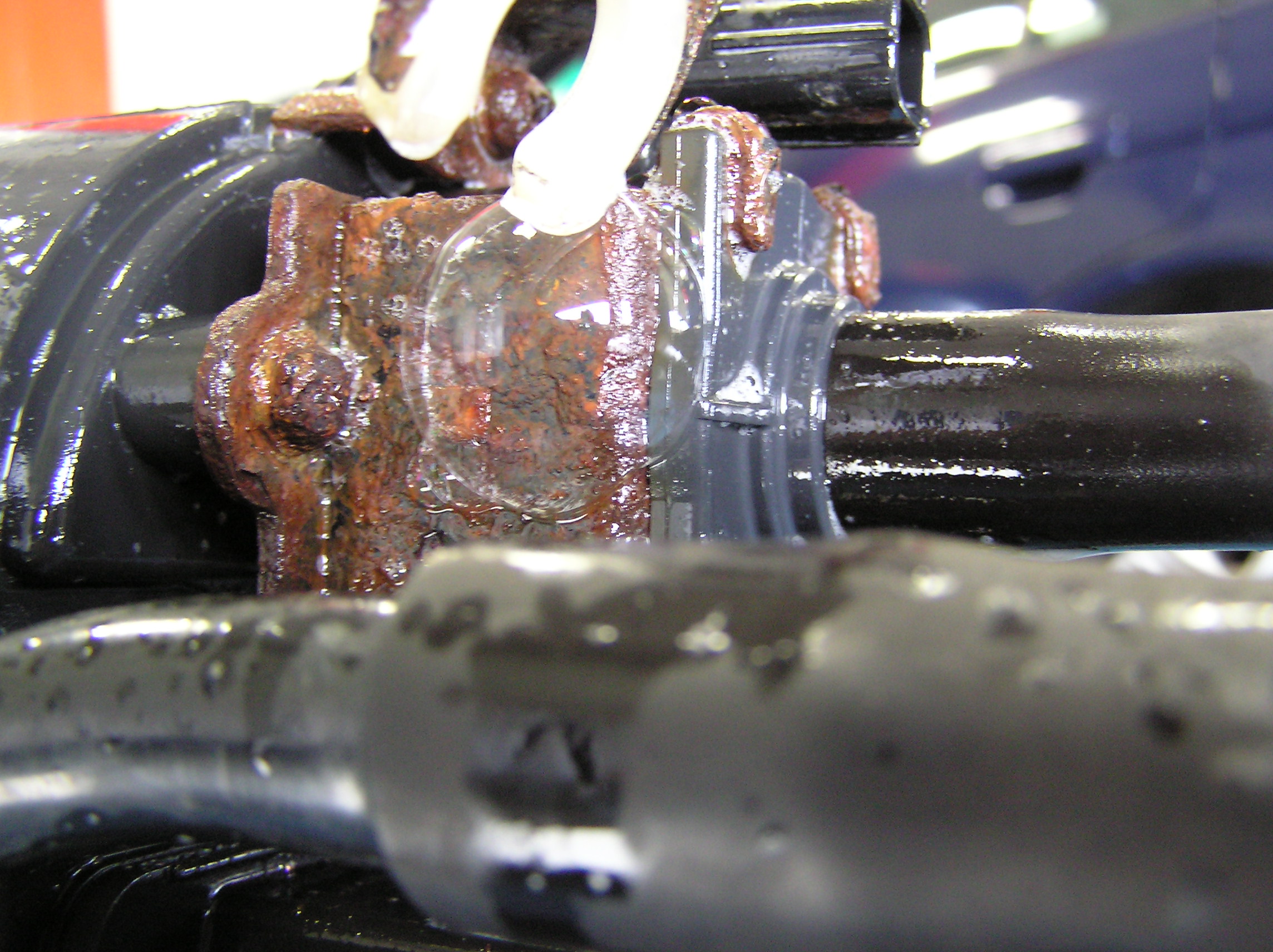

Re: 2003 Civic CEL codes P1298 and P1457
but I'm not sure which one underneath the car the charcoal canister is right inside the left rear wheel
I'm in the rust belt.
The CVS (Canister Vent Shut) valve is attached to the canister with a pair of (stuck) screws, and tends to rust through the sides allowing leakage. This has been the most common failure for me. Not the only possible failure, but I see it frequently.
This was a bench test with the whole thing under about 1 PSI pressure, sprayed with soapy water to find the leak.
