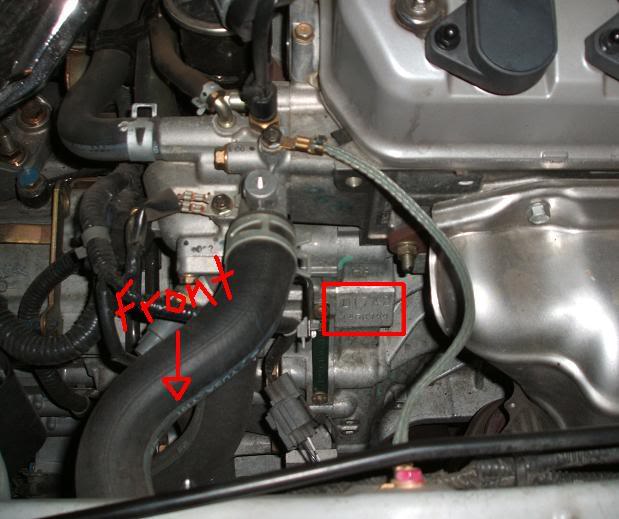

What is the engine number stamped on the block?
D17A1 or D17A2?

Not a sticker on the timing cover, I mean stamped into the block near the trans.

Thanks Ezone,
Definitely D17A2 stamped on the block.
Old Oct 12, 2015
Re: Correct oil pan??
So it's the correct D17A2 engine block I assume, the A2 should have the aluminum pan, not steel.
I think there's probably a couple support brackets and some fasteners that may be missing, they would go between the bellhousing and pan.
I wonder if someone used all the extra long bolts in the steel pan LOL
