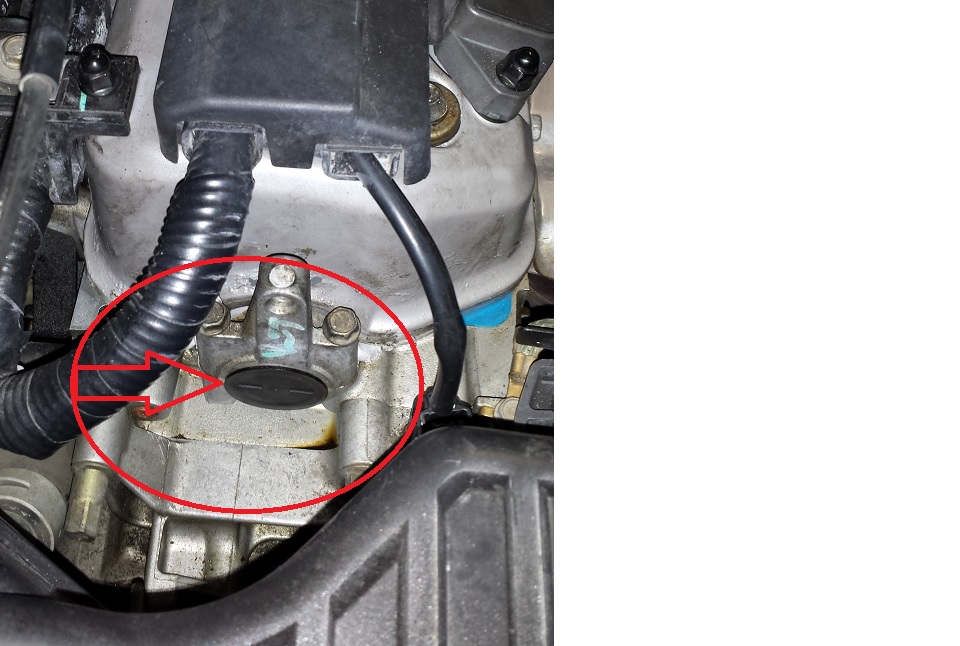

I had my 2003 Honda Civic LX Coupe serviced and the head gasket was replaced (blue) and sealed. Now, I'm noticing little drip of oil from the
"black" round piece on the picture. What is this part called? How come the dealership did not change this part as well when they installed a new head gasket (blue)?
Will I be able to replace that part myself? or does the entire head gasket need total breakdown again?

Replace the plug, it's like $9.
Honda part #12513-P72-003
It is not part of a basic head gasket replacement job.
And that blue gasket is the valve cover gasket (or called cylinder head cover gasket), not a head gasket.

Pry the old one out, push the new one in.
It's that simple.
When you pry the old plug out at least one of the plastic hooks will probably snap off, so try to fish out the broken piece(s) if you can.
The plug has an O ring embedded in it, the O ring does the sealing.

Will the new one come with the "O-ring" as well? or have to order the O-ring separately?
Thanks
Old Jun 13, 2015
Rep Power: 518
Re: Oil Leak Head Gasket
Originally Posted by jdawgzcivic
Ok, thanks again.
It comes as one piece, O ring is built into the plug.
#6 is the plug:

After a week after installing, no more leaks.
