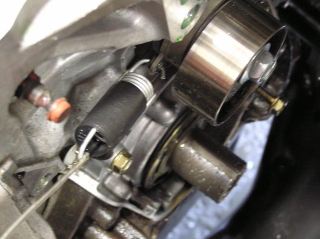

The belt is not spring loaded. It is spring tensioned and then tensioner is bolt locked.
this is incorrect,
if you remove the spring the tensioner will move without loosening the bolt,
you do not need to loosen the bolt to take tension off the belt

Mikey, that last statement in post 32 makes no sense. You do screw the bolt out but you must loosen it to take tension off to replace belt.
no you don't need to loosen the bolt,
all you need to do to take tension off the belt is remove the spring, you don't need to touch the bolt, the tensioner can swing back and forth with the bolt tight,
the only time you need to loosen the bolt is if you need to fully remove the tensioner from the block

Guess it's just been too many years. I knew when it was all said and done, One of those bolts was retorqued tight so there was not just a spring holding the play out of the belt like the accessory belt. Guess I was just not referring to it correctly. Once you have it setup and rotate it in the correct direction, the spring tensioner puts proper prload on belt (probably about 10ft pounds) you tighten 12. Then the spring no longer is applied to the belt since the tension idler is locked.

Old Feb 2, 2015
  #45
Re: Mechanic is baffled -- Please help
That was true on all previous generations, but not on this 1.7 engine.
The timing belt tensioner pulley on the 1.7L engine does not lock in place.
It is always under spring tension and floating.
The tensioner pulley on this engine is a 2 piece deal. The center hub is bolted securely to the block, but the pulley is mounted on an eccentric that the tension spring connects to.
This pic shows how I release tension from the timing belt, I never touch the bolt unless I am removing the pulley:
