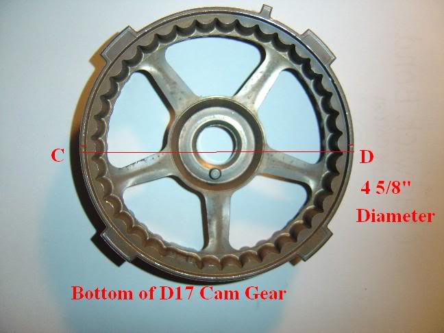

Freeze frame was supposed to help by telling some of the conditions when it set the code so you could attempt to duplicate it on demand, but you beat it with the 5k comment and the ability to duplicate it, that's really all the necessary info now.
So the definition is CMP signal intermittent interruption, and it boils down to the computer saw an incorrect number of CMP signal pulses in a specific time/revolution period. This occurred more than 30 times in order to set the code.
If you look at a cam gear, you should see 4 large lugs protruding around the edge, plus maybe a tiny one. These are what the cam sensor "reads".
What could cause the computer to "read" the wrong number of these?
IDK....I really don't have much in the way of ideas yet, and you probably don't have access to a labscope or DSO to get a real view of the signal waveform.
You don't have an 01, there was a bulletin related to the camshaft end play causing a code problem on those.....
The high RPM was making me think maybe vibration causing brief wiring connection issues, which could lead to incorrect pulses being read.
Incorrect sensor gap or varying gap between the sensor and various lugs? Any damaged lugs? Something metal or a magnet stuck to the gear?
Remove the upper timing cover and watch if anything is moving around at 5000 RPM?
Leave the belts off of it, hold RPM at 5k and see if it still sets the code without the PS or alt and ac belts?
