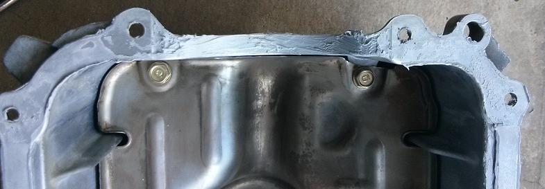

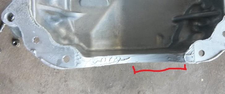

Glad I didn't go with that. There was virtually no contact on the ends.
This is the pump end. No contact on the round part.

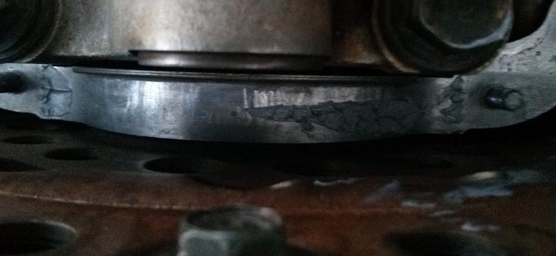

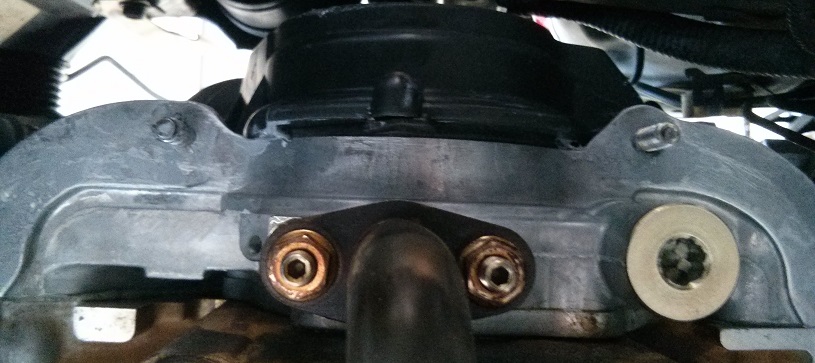

But I also got similar results on the transmission end. Only half of it made contact.

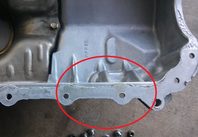

I went a lot lighter with the RTV than I did before and I think it worked out pretty well on the rest of the pan. Not nearly as much squished out. There was one spot where it looked a bit oily. More break cleaner next time.
Oily:
But about the ends what should I do? Should I just use more there to make sure there is contact? Also the directions on the ultra grey package say finger tight for an hour and then torque. Is that right or should I just go immediately to 8.7lbf in 2-3 steps?

So, about the pics: Why doesn't the pan sit good and flat against the block all the way around? What's obstructing or in the way of it? I mean, it's pretty much 2 big flat rectangles, what's keeping them from mating flat? Figure this out before you smear sealer all over it.
You may need to use a lot more sealer through the dished area under the rear main.
You have gap by the pump area? Hard to tell what......you didn't catch part of the timing cover gasket inbetween the pump and the pan, did you?
It does sit flat but just not in the dishes. Particularly the initial curve on the oil pump seems to be slightly different than the one on the pan. The rear dish is also has a small gap most of the way around when the pan is seated flat.
I think this is the answer in combination with less around the sides.
Nothing caught. Just a bad pump I think.
I think I know what to do now. I'll give it another shot and post an update on how it goes.
