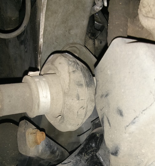

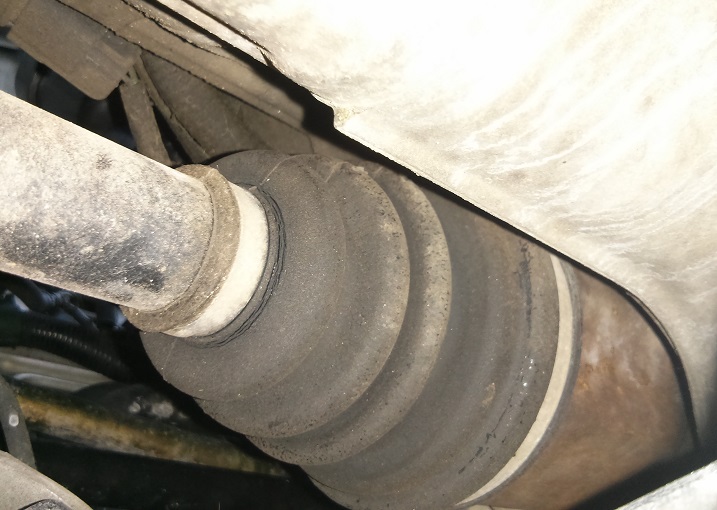

The CV joint I'm just not seeing.
This is the lower boot

and the Upper
from the top

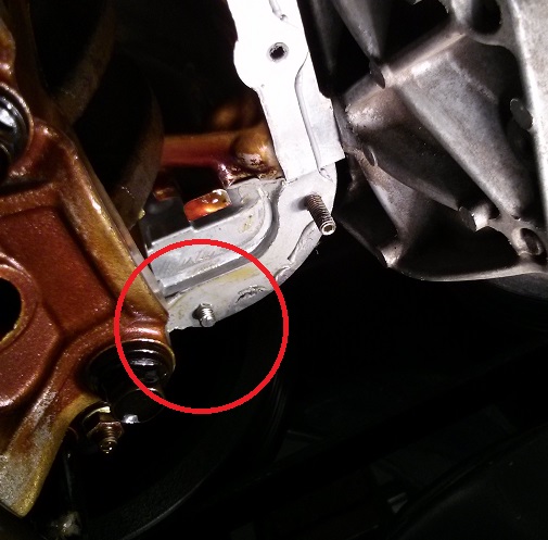

Also completely unrelated, my grand adventure changing my timing belt and replacing every seal I could including the oil pump o-ring seems to have failed. There is oil leaking from the bottom of the timing cover again. Did I just not seal the oil pump correctly? When I changed it I didn't see oil on anything in the timing compartment. Is this something I can just forget about for awhile until I have the time to dig in there and try again?
and two bottom angles
I see it, top pic is clearer. Deep weather cracks in the rubber around the small end band clamp, about 1/8 inch up from the clamp.
Not a disaster yet, but will probably become a leaker in the near future as the weather cracks rot all the way through.
Also look for the same types of cracking between the larger bellows or ribs of the outer boots.
Honda sells boot kits. If the CV joints are in good shape, I would have suggested rebooting the axles instead of replacement. More labor intensive though, but probably cost less than purchasing OEM axles. (Aftermarket axles can be a crapshoot)
As long as you are certain the timing belt is not getting wet with oil, then probably.

Depends on the type of boot involved. Is it just a cover that is free to let excess grease out, or is it a sealed boot like the original was? Are there any cuts in the rubber?
Also, that joint looks like a replacement already.
At the end of April, the service that made me decide to figure stuff out for myself, I had new front lower control arms and ball joints put on. The ball joint part on the invoice is listed as OPP OPMSP(what does that mean?). So I'm not sure what kind of boot it is. I'll check it for cracks tomorrow but from the picture it looks cracked and judging that the right one doesn't leak and they were replaced at the same time, I'm going to guess it's not supposed to. If I got an OEM boot would it probably fit on there?
Wait, the FREE inspection didn't catch this?
Well I can't be certain without opening it back up, but the previous timing belt didn't have any oil on it and thus far its not a big leak.

I will definitely just replace the boots if I can get away with it. How common is it that the joints go bad?
CV joints....could outlast the car if the grease doesn't leak out. OTOH I still occasionally see joints bad, causing noise or vibration-- without leaking.
Oil pan seal leak?
  1. Turn the driveshaft by hand and make sure the splines (E) and joint are not excessively loose.
  2. Make sure the driveshaft is not twisted or cracked; if it is, replace it.
The manual gives these as the inspection steps. How much is excessively loose and in what direction would it be? And twisted like the rod would be bent?

Oil pan seal leak?
Definitely could be. Looking at it closer again it looks like there is a drop on the front "tab" on the corner of the pan as well as the bottom of the timing cover. The pump o-ring is at the rear top and I usually park on a slight incline so that means its probably the pan seal right?
That criteria is pretty ...weak... for a DIYer to be given. All CV axles have some amount of play, and "twisted"? Seriously? Who has enough power to do that in a stock car?
Experience and comparison should be the guide, and it's awful tough to give subjective and loose criteria in print.
I dunno, I can't see it. Clean it all off thoroughly and hit it with white powder, that should help show a trail when it starts leaking.
I understand. I get maybe a couple mm of movement side to side on the whole axle and in any other direction I think I am just pushing the whole car.
What kind of white powder?
Don't worry much about it.
Noisy is bad. Shaking (usually on acceleration) is bad. Broken is bad.
White.
Bath talc.
*Right Guard.*
Foot powder.

I don't think I know the difference. It seems to fit pretty tight.
This is the right boot that wasn't leaking. The left looks pretty similar.
Old Aug 4, 2014
Re: Airbag recall and other questions
^That doesn't look like a simple cover, that looks like the big end is pressed on.

First lets wrap up one minor catastrophe. Here is our friend the june bug about 1000mi later.

And finally the new minor catastrophe. One of the front studs that comes out of the block snapped in half. What the heck do I do about that? Does that bolt come out?

A much larger wrecking bar was all we had, but that worked!
I LOL'd.
In an ideal world, it should be able to spin out because it's just a threaded stud.
Maybe. If it isn't stuck.
Good luck.

Well the good news is I was able to get all of the studs out of my old oil pump. The bad news is the new after market oil pump they seem really stuck in. The non broken ones have hex sockets in them but I wasn't able to turn them with the cheap allen key I found. Hopefully a better one will do it. The broken one however there is practically no way to grab it between the crank pulley and the ac compressor. Also all I have are regular old pliers.
Any recommendations on what kind of tool would be good for grabbing that bolt in tight spaces?
Old Aug 5, 2014
Vise grips? You are replacing it, you don't care if it trashes threads.
A little heat should soften loctite if they put it on the studs.
You only need to change the broken one.

That was the winner. I had to pop the crank pulley off to get at it from the side but I finally got it out and the good one back in. I tried renting a set of those stud pullers from autozone and then bought/returned that exact set you pictured from oreilly. Neither could grab the stud. There just wasn't enough there. The oreilly ones did grab on the other full studs though.
Now just need to clean it and put it all back together. And hope I seal it right this time.
