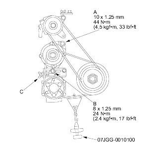

Re: Limp Mode
Which bolts are we actually talking about here? Personally I never really thought about how it worked enough to consider that the bolts might be a ground.
Just the top bolt? The adjusting bolt? The bracket mounting bolt too?
All the important ones! Every one of them is important!
Research "chassis ground" and report back with your findings. There will be a test on Tuesday.
http://www.wisegeek.org/what-is-a-chassis-ground.htm
