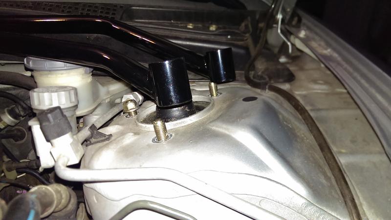

I have a 05 Civic EX Special Edition 5-speed and I recently bought the neuspeed strut bar for the front. Unfortunately I cannot get it to fit due to the bar being too long (or the strut towers being too close.....).

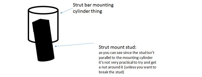

So I spent some time manhandling the bar and I managed to get it to slip over the four strut tower bolts, however at that point I can't get the nuts back on to the bolts due to the clearance between the side of the bar and the bolt (see below)

Also when it is on over the bolts, it doesn't clear the hood when closed, which probably means that the bar is sitting to high from being compressed to fit between the towers
I suspect that this is due to the fatigue of the strut towers caving in over time (the car has 120K miles on it and never had any support for the towers). Is there anything I can do about this or is there no hope of getting this strut tower bar on?

lift the car. the towers should spread a bit. be careful, these bolts holds the whole suspension up.

I tried lifting one side of the car, then the other, and both. This managed to get the bar on over the strut tower mount studs, but not straight (as in the illustration) so there's no way to tighten down the nuts even with a lower profile socket.
I want to install a bar to prevent further caving in of the towers, so if the uni-piece is too big, is there another adjustable one that might be better? Or perhaps one that has a lower profile bracket (i.e. not giant cylinders) for attachment to the strut mounts?
