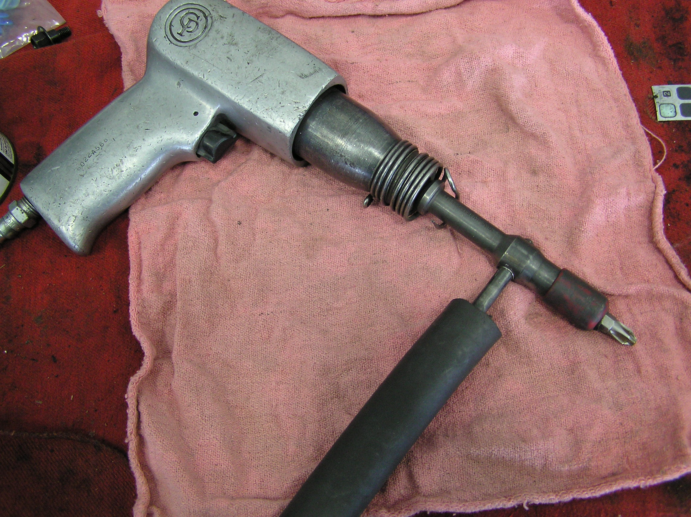

Its not Honda specific and you probably have one but an impact screw driver is great for removing those dern brake rotor screws that Honda uses.

yes, that is pretty much a definite must have tool to work on any car
my rotor screws were on so tight i had to hit it with the back of an axe, a hammer was not strong enough!

Yep, impacts are definitely required for work on powersports stuff, esp watercraft. My Craftsman one is well-worn -- mosdef saves time. And @ezone, the Blue Point valve adjusting tool in the above pic is what was in my link... so, then it is required on a D17, huh... pricey but for ease of use really can't beat it. Done....

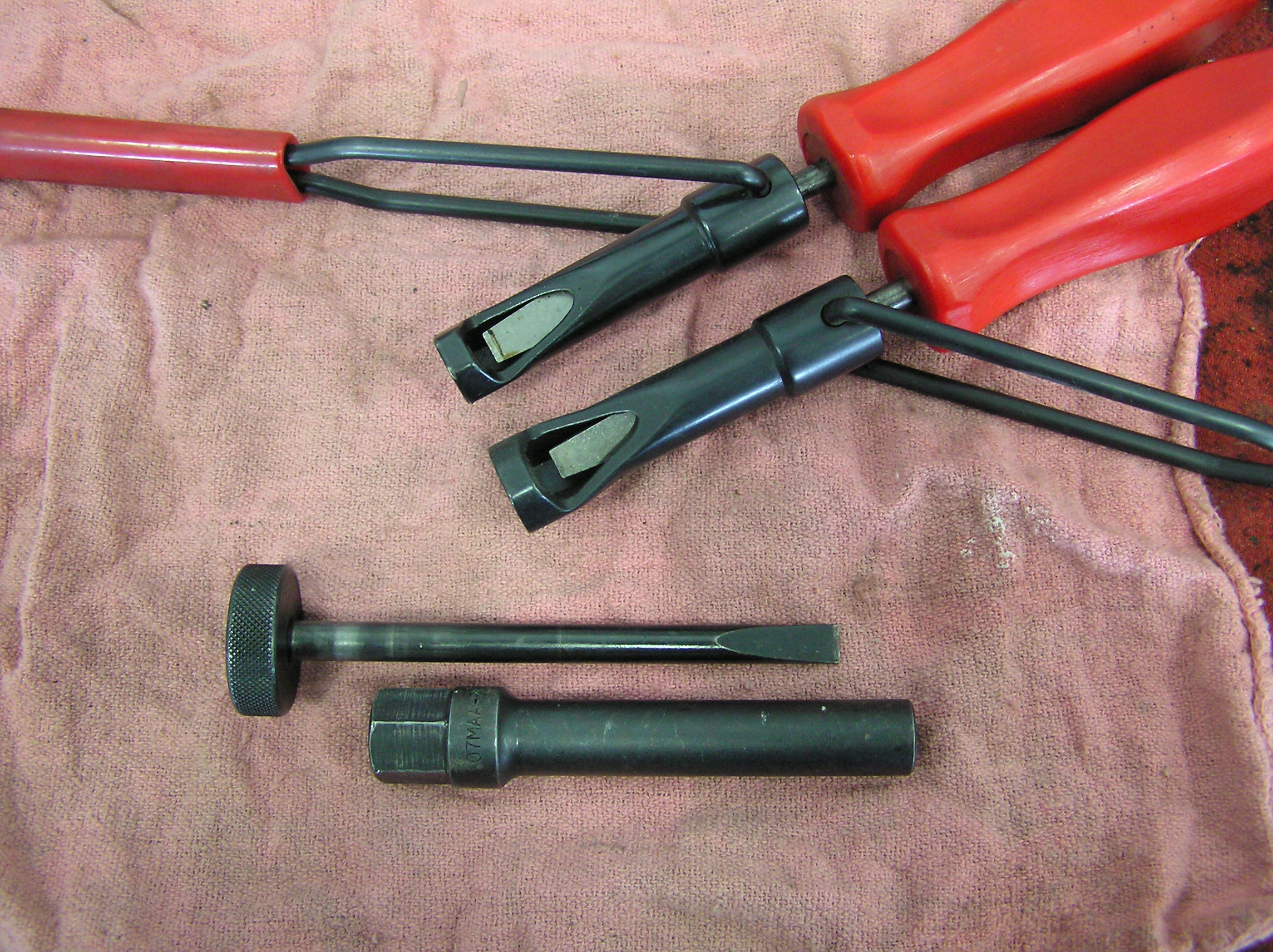

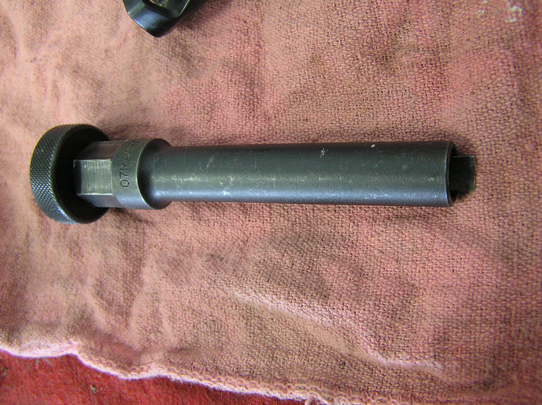

My first choice is regular box end wrench and screwdriver if they will fit.
Second choice is the tube driver at the bottom of the pics, along with a box end wrench.
Last choice is the red things.
I use whatever is handiest and fits best for me. I think any box end and screwdriver will work on a D17.

@ezone: ah -- okay, thanks for clarifying that. I was watching a YT vid on adjustment on a B18C, and the access pretty much demands the BP tool. If the screw/locknut is regular-tool-accessible on the D17, win for everyone (I thought they were from pics I'd seen on the forum but it pays to check twice, do once).

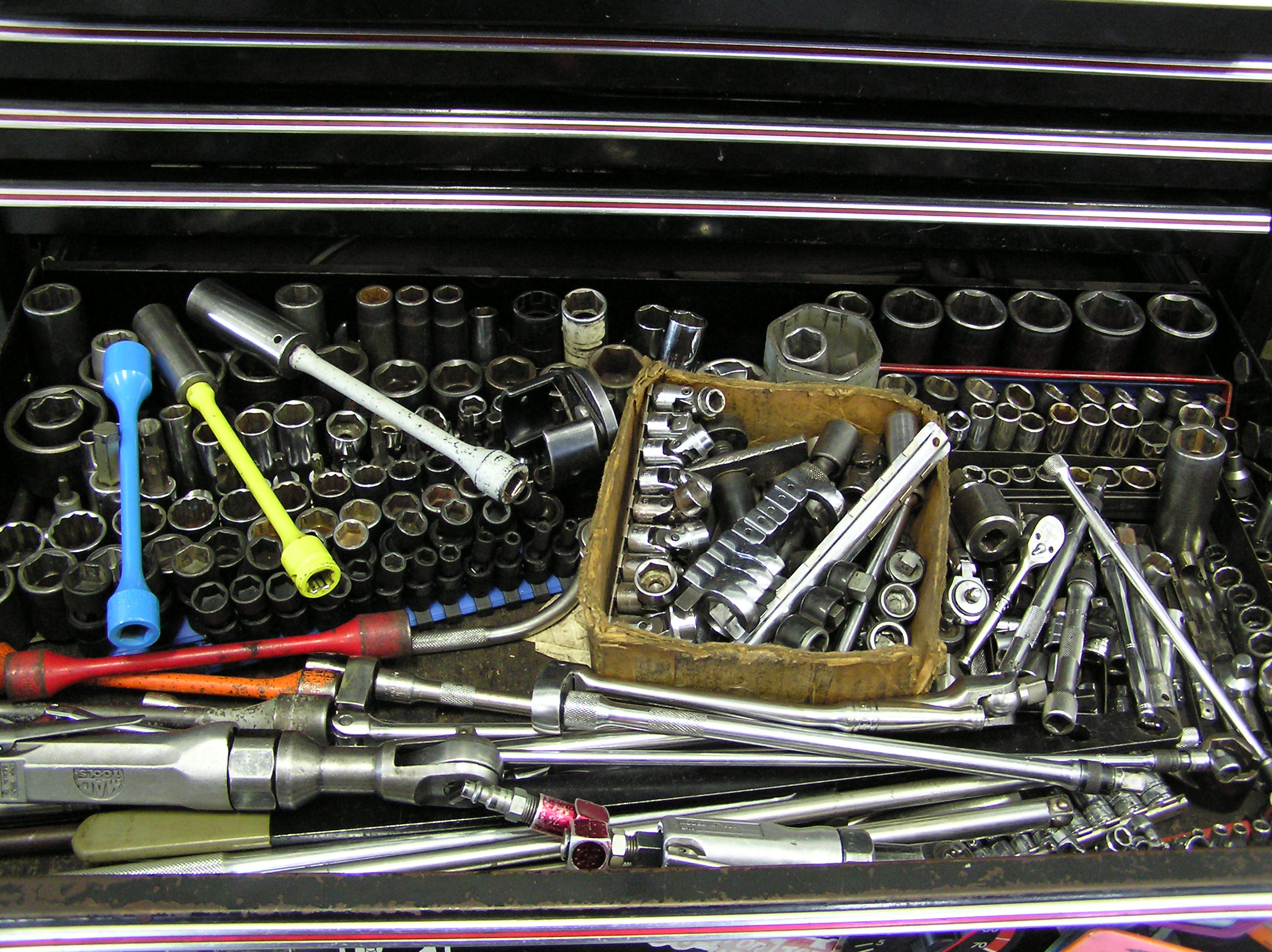

Maybe 2/3 of my sockets n stuff....
Organized? Suuuure.

Holy pixel mural!

Should I have given the dial-up warning?
Resizing pics isn't my thing. Point, shoot, upload, link.
It didn't seem that big when I first loaded it . I'll have to recheck the camera settings, maybe I bumped something since I took pics of the valve adj tools.
