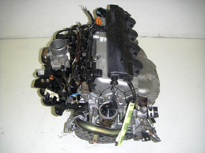

Question 03 oil leak issues
ID:	86412hello forum, i have a 03 sedan lx model, i recently changed the valve cover gasket but i'm still having oil pool underneath this area. is there a seal behind this area that could be causing the oil to pool? i've checked the gasket and it's sealed tight. no one at the particular parts stores around here can seem to find what part this calls for. any input would be greatly appreciated.

You need to replace part #6 in this diagram (less than $10):
6 Part #12513-P72-003 PLUG, CYLINDER HEAD
This is where a distributor used to mount to before Honda started using the Ignition coils over the spark plugs. The o-ring in the plug wears out and is notorious for dripping oil.

^#6, gravy.

thanks a lot. going to get on top of it asap.
