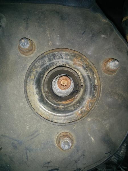

Attached are pics of the top of each strut tower.

Take note of the shredded rubber on the 12 o'clock for the picture on the left.
Take note of the shredded rubber on the 3 and 7 o'clock for the picture on the right.
When you press down on each strut tower, it is obvious the towers are shot. The shredded rubber was the main sign I noticed which made me check out the struts and towers.

Rubber bushings are starting to break loose from the metal and come apart/crumble as you turn the steering wheel?
I can't tell you what's the cause of yours...... maybe consider age and miles? Mount plate bearings shot?
I have seen some that were apparently ruined by the installer, tore the rubber in their mounts by tightening/torquing the large nut while only holding the top plate, instead of putting an allen (hex) wrench in the end of the strut shaft and tightening against that.
The rubber bushing in that top plate wasn't designed to be forcefully twisted.
It was only designed to give a bit of compliance to let the shaft move up and down a wee bit and wiggle as the strut moves (as the steering turns).

Originally Posted by j.squared
EZ - they have less than 50k mi on the struts and brackets. Age shouldn't be a factor yet, should it?
Had to read the OP a couple more times.
The car no longer has factory parts. Right?
The factory parts (strut tops in this case) would normally last the entire life of the car, for most people.
You installed aftermarket parts, of questionable quality. (The KYB shocks themselves might be ok, but other parts of the setup apparently were not.)
(Side note: Guess why aftermarket shock absorber companies recommend replacing shocks and struts every 50,000 miles!)
Trouble now may be that factory parts might no longer be an option. Some brands of the quick strut assemblies are JUST different enough that you can't use factory parts and you are stuck fixing them with more inferior parts, or replacing the complete units all over again....or putting on all of the factory parts that were taken off (nobody ever saves them).
Some bargain.
I've never heard of replacing the bracket without replacing the strut.
You've never heard of replacing ONLY the strut by itself either?
Same damn thing.
That's the reason you can buy all these parts separately from the factory.
I'd attempt to fix them with OEM strut tops first. If they don't fit, then you are ________.
In the shop, I really hate to see those aftermarket quick struts. I don't even want to touch them.
