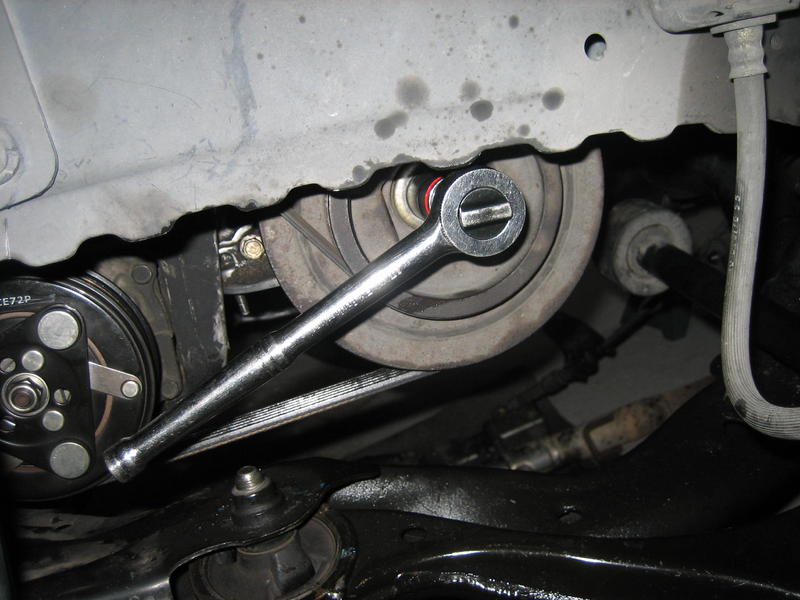

-Connect the Honda tool to the crank pulley and use left hand to rotate the crank opposite the two tab side while pushing with the screwdriver

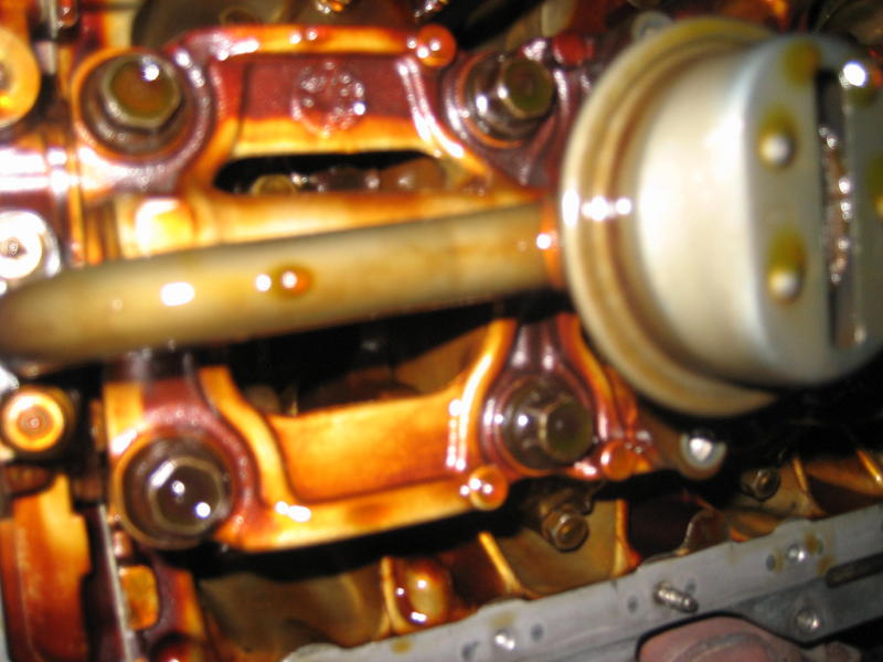

1) This job should definitely be done with any oil pump work because I had way more clearance when mine was out.
2) ezone was dead on that a pick was the way to go - I was easily able to fish the bearings out with the exception of one

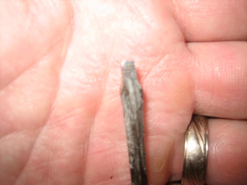

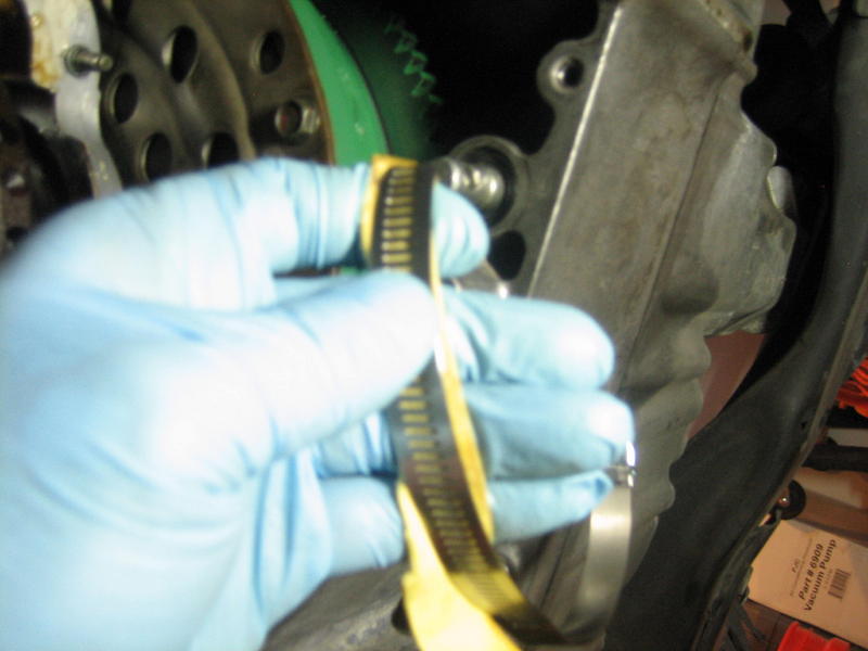

3) I fabricated a special tool using my favorite dremmel fitting and an old tiny screw driver. While it wasn't the best for not impacting the tab area of the block, it seemed to do the trick
4) I cleaned behind the crank by getting a large screw clamp and sliding it around the crank with a piece of shammy cloth - I feel like I got quite a bit of oil
5) I followed up with some shots of brake cleaner and then shammy - I actually think it was pretty clean

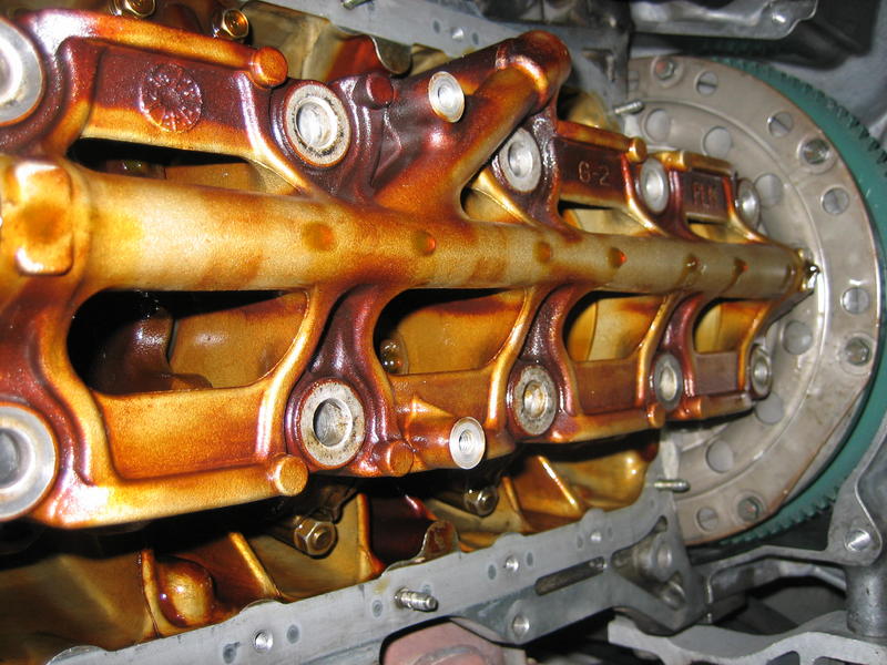

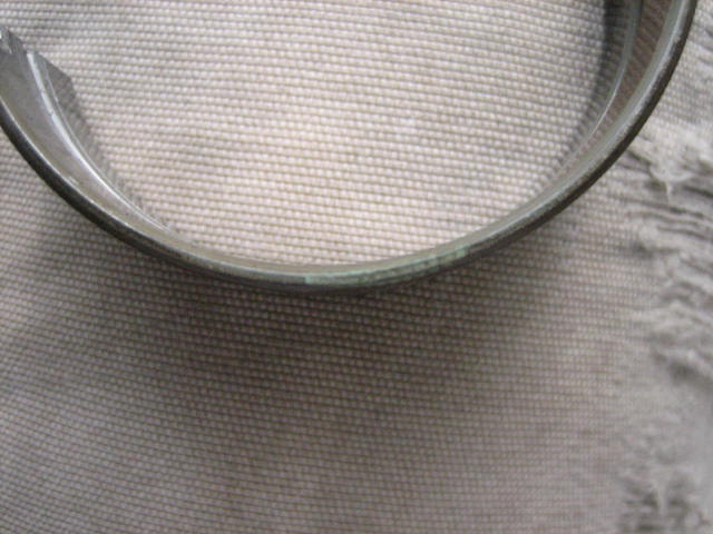

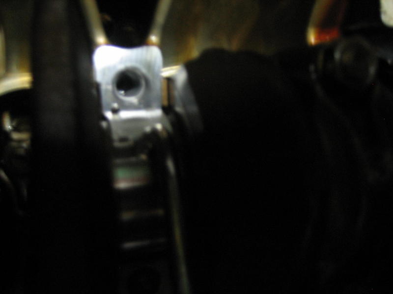

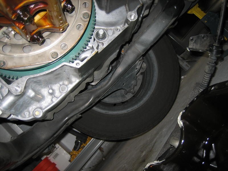

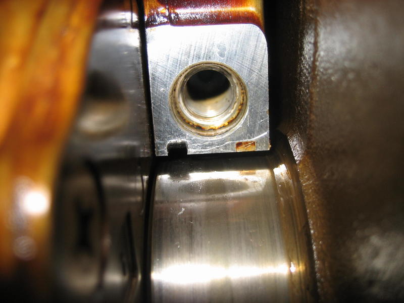

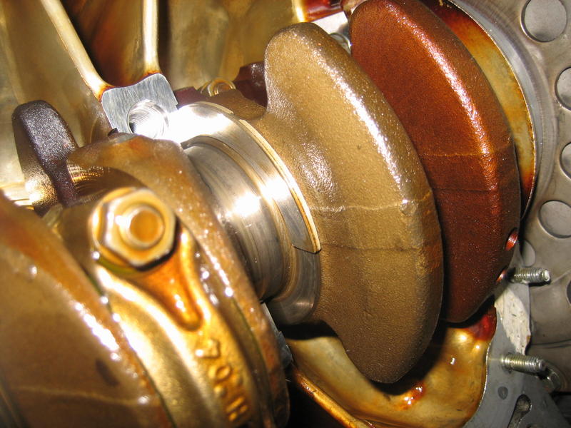

7801 - Stuff that's gotta come off

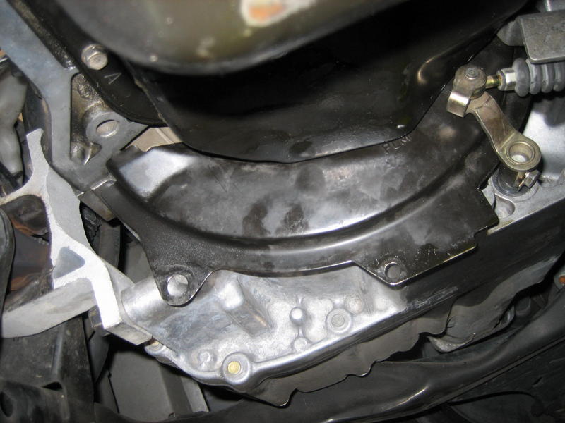

7802 - Torque Converter cover plate removed

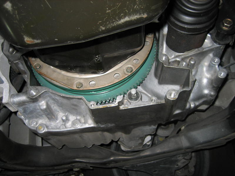

7804 - Oil pan off

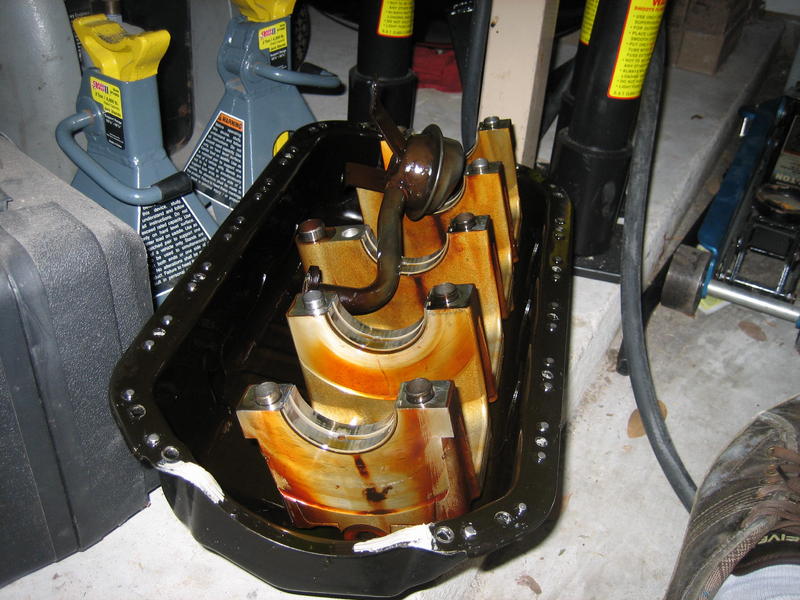

7806 - Oil pick up about to come off
7807 - Oil pick up off, shot of main bearing girdle

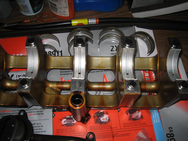

7808 - All of it sitting together - made clean work area and cleaned, lubed, covered with plastic wrap
7809 - Main bearing half - had to look at the color of the bearing on the side since I didn't have the code off the block, don't use brake cleaner. Gently rub with your finger and it will get the grime off.
7815 - clearance after removed and a shot of the tang slot
7818 - thrust bearings trying to creep around and fall out
7819 - how I turned the crank from under the car
7824 - The best frigging dremmel tool ever, could drill out superman's knee cap
7825 - "Special tool" used to pry out the main bearing via the tang tab
7851 - "Special tool" used to clean out behind the bearing (go slow and don't get metal on metal"
7851 - Hard to see but a stuck a 90 degree screw driver into the oil port, and turned the crank on the bearing (similar to video with cotter pin) to get the bearing around the crank - go slow
7854 - Plastigage on the main bearing girdle
7804 - Oil pan off
