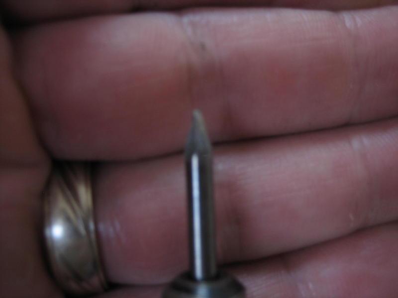

2) ezone was dead on that a pick was the way to go - I was easily able to fish the bearings out with the exception of one
3) I fabricated a special tool using my favorite dremmel fitting and an old tiny screw driver. While it wasn't the best for not impacting the tab area of the block, it seemed to do the trick

7825 - "Special tool" used to pry out the main bearing via the tang tab
