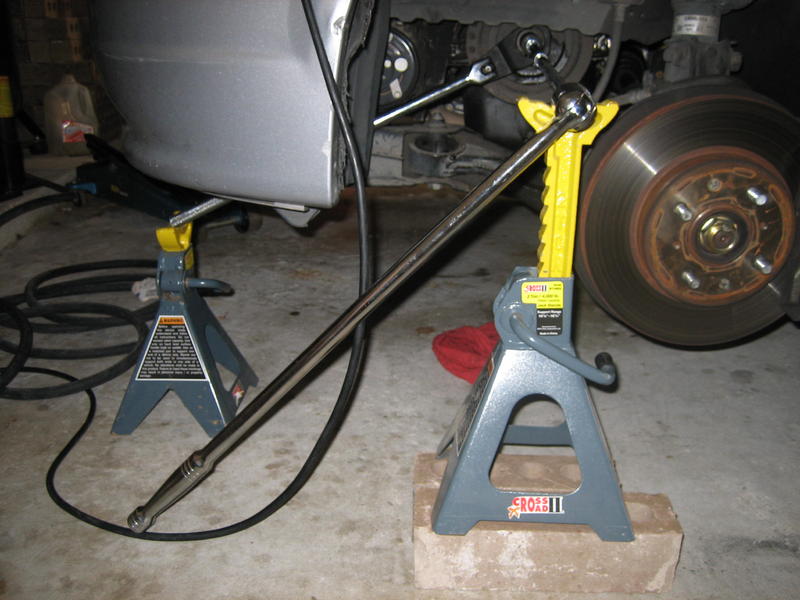

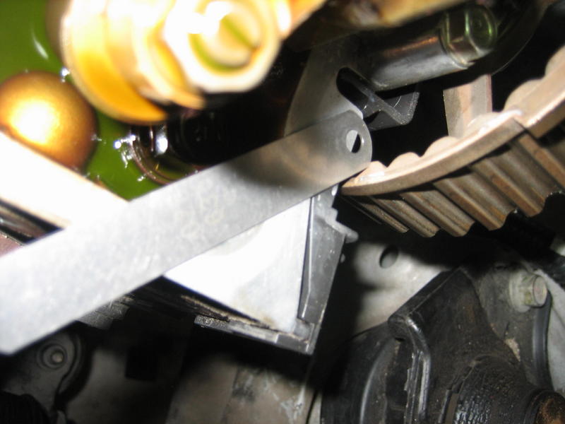

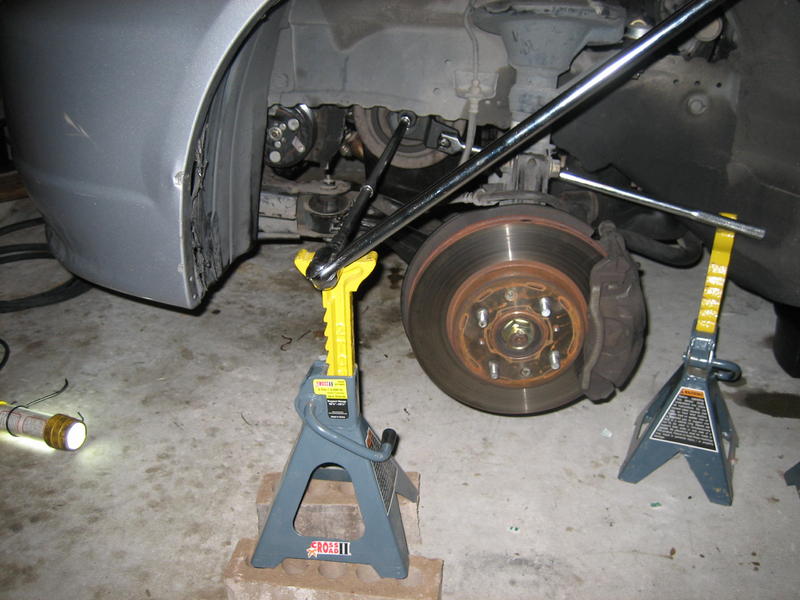

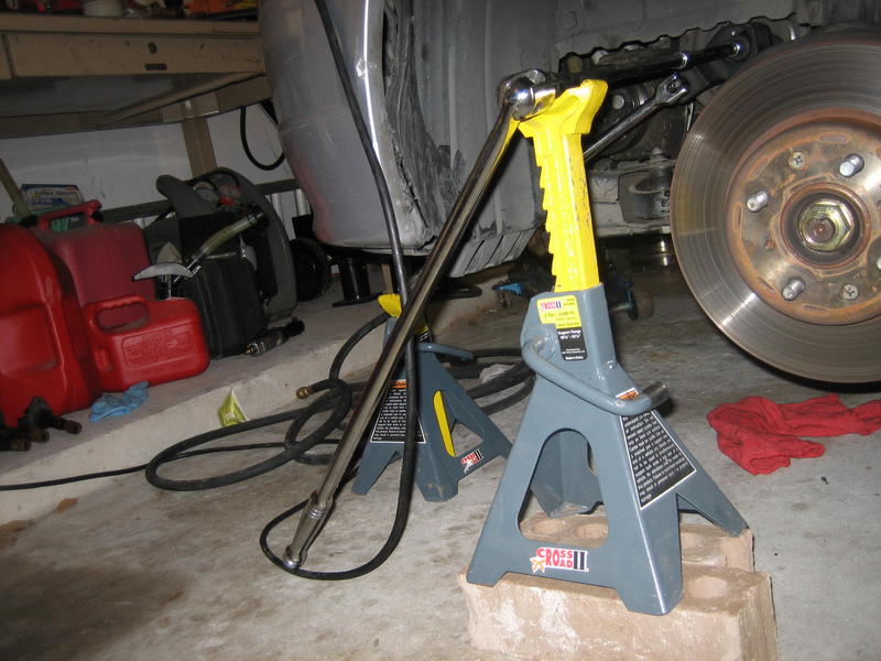

This is how I roll...picture is worth a thousand words. I don't think it is that hard, personally, and I'm no expert. I use two 1/2 inch breaker bars, one is big bertha. Couple of extra jack stands it you're in business.
To get TDC I use a straight edge off the block to the marks on the Cam Pulley with the UP in the UP position. For the bottom I look at the crankshaft about 18" away and use the marks on the block.
