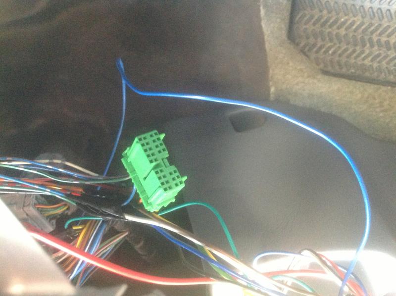

Hello, im having door lock problems and just found this plug disconnected. I cannot find where it was connected! The factory keyless entry system was spliced into it. Its located under dash just above hood release lever,
2005 civic EX sedan

It should plug into another plug that feeds through the door. See about 1:28 in: [autostream]http://autostream.com/ibcivicforums/?page_type=firebirdplayerthumbnail&framepage=1433& transactionid=1378239478-6718518949&posted_by=_www.civicforums.com&youtube_ video_id=-TG8NYXjqgk[/autostream]

Ok, so i researched and found its the factory alarm plug. I dont believe its supposed to be plugged in . Just a splice point, I believe. I have no door lock clicking or action on the passenger side front and rear door. Any ideas? Does a wire control passenger side door locks?
Thanks!
