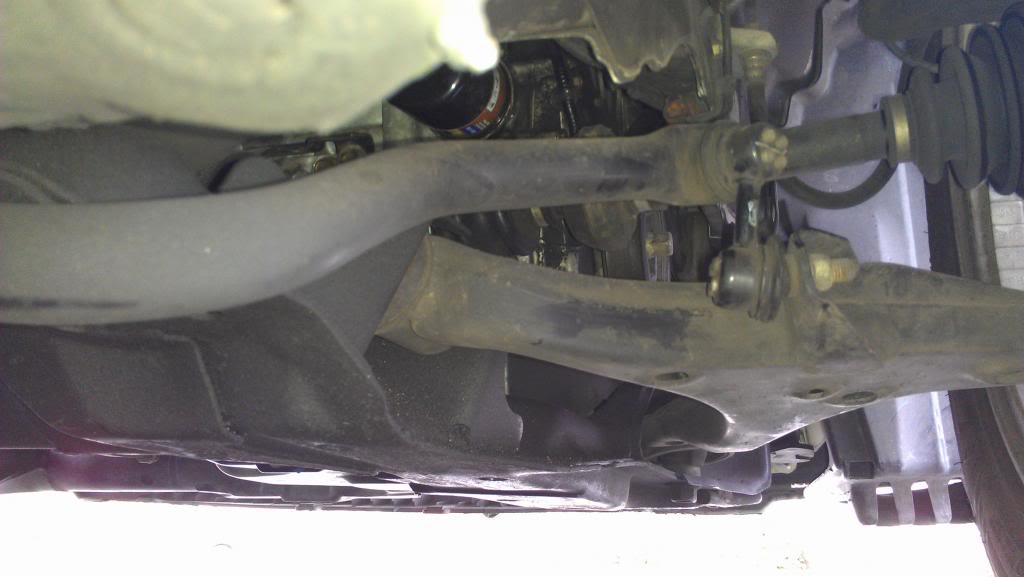

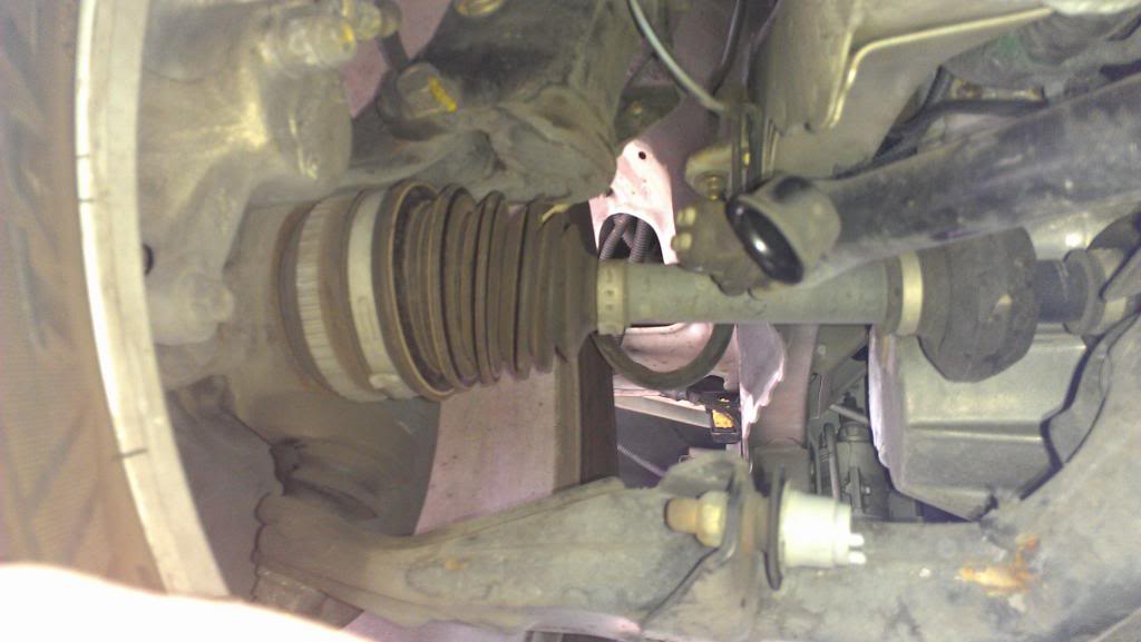

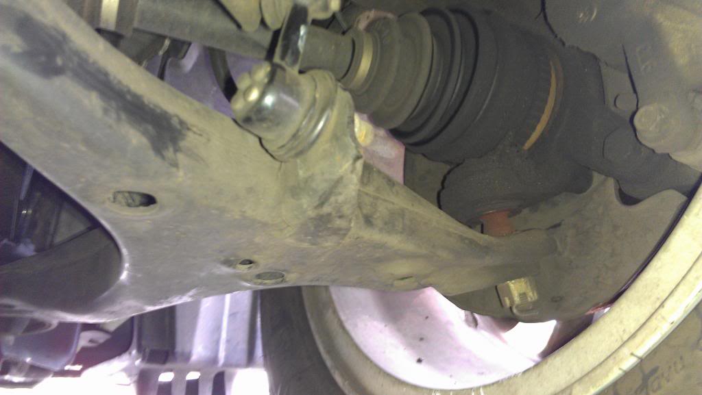

Summary:
I power slid into a curb doing about 15 mph, tops, on a right turn. The curb was about 7 inches tall, but was still able to do damage.
What I know:
1.) My left control arm needs to be replaced
2.) My sway bar connector needs to be replaced
Questions:
1.) My sway bar seems to be bent upwards in the picture. Is the sway bar bent upwards because the connector was holding in all the tension, via sway bar connector, or is it broken?
2.) What else might need to be replaced, according to the pictures?

FYI: Left and right are always determined from sitting in the drivers seat.
Don't stand in front of the car and call it, you will get the wrong parts every time.
On a 7th gen, I should not see the oil filter anywhere near the right side of the car. Unless your pics are backwards? I think the pics are flipped backwards.
Can you fix the pics so it isn't so confusing?
Don't worry about the sway bar itself, it will move as the other corner moves. If you only jacked up one corner off the ground, the swaybar is still attached to the other front corner and that now controls the sway bar movement.
Pic #1 I can't tell where it is bent, but I suspect it folded right where the rust colored spot is just to the right of the broken swaybar link is. The black paint will usually crinkle and flake off where the suspension parts bent.
Pic #2 I can't see anything wrong except I'm looking at the drivers side, not the right side. EDIT: PIC IS BACKWARDS
Pic #3: WARNING: I see a bad ball joint, its protective rubber boot is completely AWOL (missing) and the joint has the appearance of being rusted so I'll guess the boot has been missing for a long time. It will become dangerous as the joint wears out---if it isn't already worn out and dangerous..
Old Aug 2, 2013
Posts: 15,181
Likes: 1,606
Re: updated curb damage. please help
1) swaybars are made to twist, duh...
2) your endlinks to the swaybar are waaay weaker than the swaybar itself - they will break first so you replace a cheaper part, so good there.
3) as informed before, your control arm is bent, not the sway bar, duh!.
before looking at the swaybar, just notice HOW different the left/right control arms ARE. replace it first then go to mental masturbation. t's not your worrisome item that is outta place. it's you reference point outta place.
Sorry man I don't understand what your saying when you say, "mental masturbation," and "it's not your worrisome item that is outta place. it's you reference point outta place."
so all thats wrong is my sway bar and sway bar connector?
Old Aug 3, 2013
No, man!
The lower control arm is bent, it's BENT, IT'S FREEKING BENT! (that's the outta place comment) Replace it.
The sway bar itself is fine. It is a (torsion) spring. Quit worrying about that piece. (that's the mental comment, I think)
The sway bar connector is broke. (We call it a sway bar link.) Replace it.
How about checking the wheel bearing for noise? Can you do that?
How about checking the wheel and hub flange for runout (bending) -- can you do that too?
I also seem to remember the one wheel looked like it suffered some damage too. Check that.
Then have a wheel alignment done at a good shop. If it aligns OK at that point, you might be finished. But if it won't come into specs, then something else is bent and needs more investigation to figure out what it is.
Now would be a great time to take care of that ball joint I mentioned, since the job should include a wheel alignment also.
And your pics still seem very backwards.

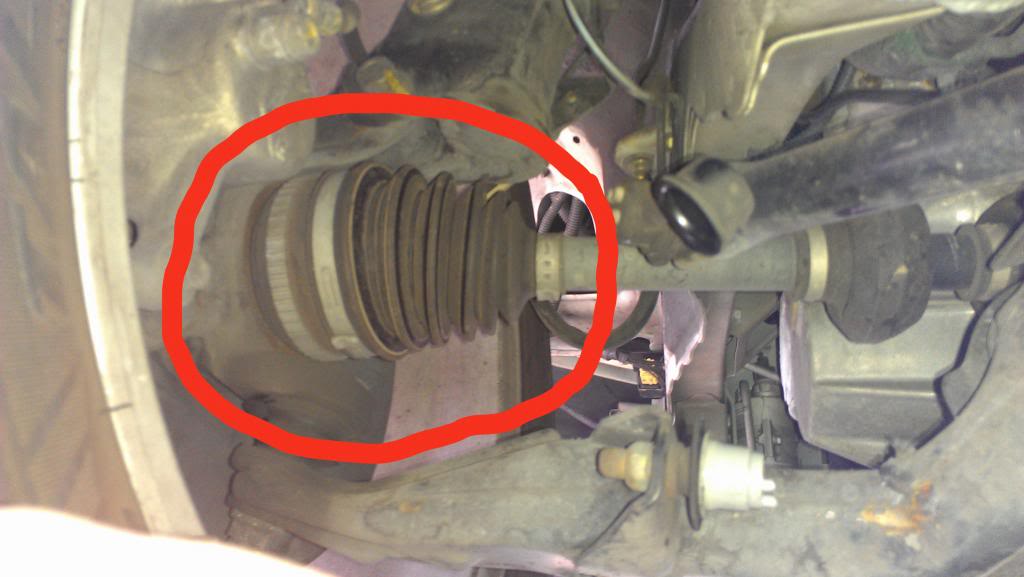

two more questions:
1.) Is my left axle okay?
2.) Can I drive it to the mechanics shop, or should i get it towed?
Look at the connection point between the axle and the wheel. It looks different from the non-damaged side.
Thank you.
Old Aug 6, 2013
1) Yes. Wait.....point out exactly which part you are calling an axle first. Ball joint is a big problem, not axle.
2) Once all of the wheels can point forward again, I'd drive it to the alignment shop.
Is the ball joint broken??
The part you circled is a C.V. Joint, it is part of the axle.
Old Aug 6, 2013
Does it look broken in anyway?
and what do you think of the repair costs?
Old Aug 6, 2013
Looks fine from here.

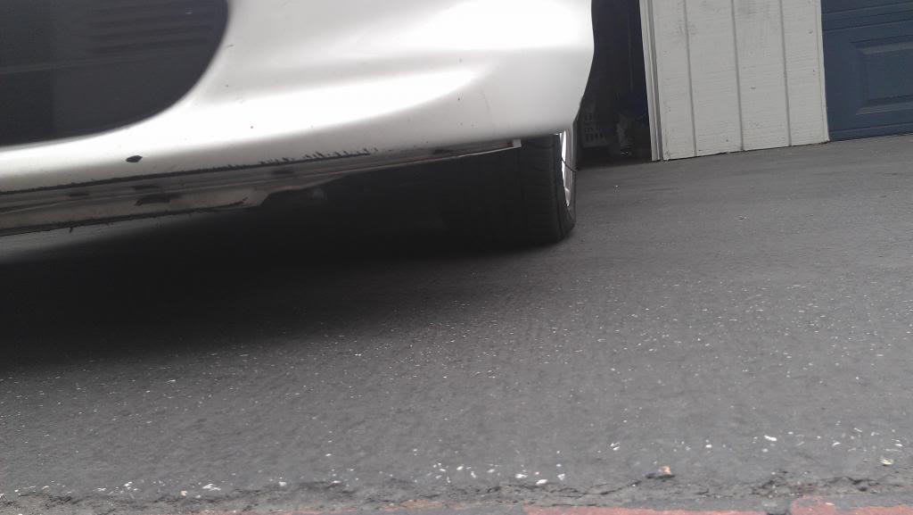

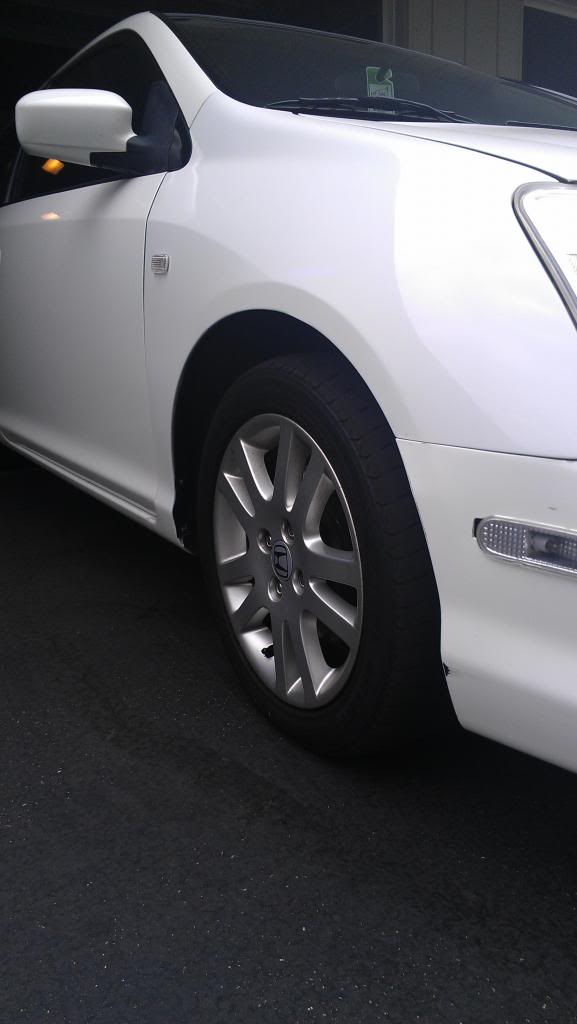

4.) Do all 4 tires point straight ahead?
No. The left, affected, side is not pointing entirely straight here is a picture of both right and left wheels, pointing straight.
Not affected side:
Affected side:
5.) Can you afford a couple of new tires on top of everything else? (Because you will rapidly EAT the tread off of the front tires if they both point different directions.)
No, I cant.
