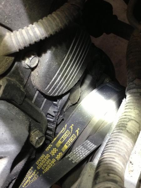

I have attached some pictures that we took on how the belt looks like from what we can see outside....

FYI, the pictures you have are of the accessory belts not the timing belt. The timing belt is behind the black plastic covers.
I almost posted the same thing, but noticed that in the second pic, you can see the timing belt through the gaping hole in the lower timing belt cover
edit: make that both pics.
Yeah I see it now. Broke lower timing belt cover and chewed up timing belt, check.
edit: I can't tell what's going on there with the timing belt. It almost looks like it's sticking out of the lower cover.
Yes, that's right.... the cover also got a hole and the belt is sticking out. I don't know what happened and how the cover got to that state.

Yeah it looks like the timing belt cut through the lower timing belt cover because something let go behind it. Get to a trusted mechanic and figure out what's going on behind there. It looks like you need a minimum of a new timing belt and lower timing belt cover at this point. I'm sure more damage will be revealed underneath the cover.
