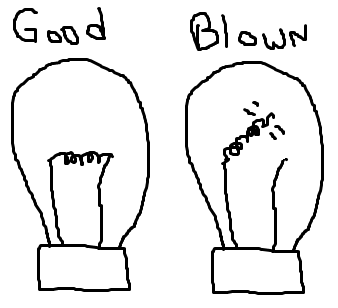

fuses? Physically look at the bulb. If it were blown, the filament would be anything but stationary, if there at all
/enter the most awesome MS Paint drawing ever
If it's a dual filament bulb, there will be 2 sets of filaments, and at least one will look like the "blown" side.. lol
