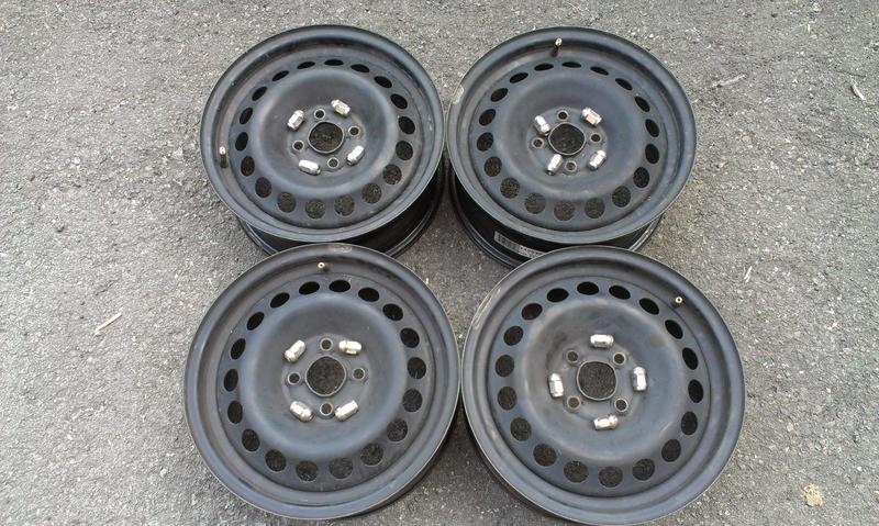

Also, I managed to solve a problem of vibration at high speed when I had the tires installed on another set of rims, other after market rims that I bought at at Wal-Mart.
The garage diagnosed that the inside of the rim didn't match perfectly with the wheel hub of the car, thus causing the vibration.
He offered me to buy another set of 4 from him that would fit perfectly. After removing the tires from the rims and installing onto his rims, he realized that the lug nuts didn't perfectly match with his after market rim stud holes, and that it was probably contributing to the vibration. He said Honda OEM lug nuts didn't fit universal rim, and sold me universal lug nut that would fit the new rim,
Unfortunately, I lost a great deal of money by buying Wal-Mart rims.
What I want to know is if it was actually the rims, the lug nuts, or both of them, that way I can know if it was a waste to spend money on another set of rim.

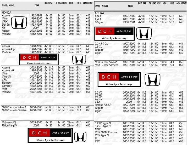

What kind of offset would position the wheel/tire in a way that it would pull the car in a certain direction?
It pulls BOTH directions.
Since you asked....
Anything that changes the designed geometry of the suspension could cause unintended or unwanted effects.
Changing the offset of the wheel to move the tire outward can cause what you described, the "wandering" effect. Road forces can cause the tire to turn the steering wheel.
Changing the height of the tire can alter these angles too.
There is a lot more to it than just that, but I'm trying to keep it simple.

About the wheel offset, anyone knows this car's OEM wheel offset?
I'd like to measure mine and compare, see if there's a difference.

OE offset is around +38mm, selection of different ones would depend on wheel width (tire rack could select a wheel that way *excluded the factors for lowering*, of course...)
if the previous set of rims were rubbing and this one is not, i think either the lug nut and the wheel/hub fitment could explain this.
oh, wait, new ones rubbing too? recheck tire rack what they recommend for stock height suspension, same width wheel.
if not the case, it could be the wheel have something protruding that rubs on the drum? It's not a big brake, after all.
have you disassembled wheel to look at?

The rubbing noise was happening with the previous set of rims (not winter set) and the one I currently have.
It's probably a brake noise instead. What has been done to them?
The original rear drum brake shoes can last well past 200k for the majority of the cars and drivers I see here. They just don't wear out like the fronts do. Maybe 5:1?
The complaints I see tend to begin shortly after someone does a rear brake job with aftermarket parts.
Rust buildup in the lip of the drum, contacting the backing plate as the drum spins?
re: Car pulling left/right after new tires on uneven surface SOLVED
Unfortunately, I haven't disassemble the wheel in order to look at the wheel and the drum/hub assembly.
That makes me doubt it is a wheel fitment issue then.
I may not have been clear enough about the wheel.
Until now, for the new tires, I have tried two set of aftermarket rim, and they both cause that rubbing noise at the same wheel/side.
Nothing at all, haven't replaced the drum, the shoe, or anything in the spring assembly.

Alright, the issue about the car being pulled to the right/left, the fact that I hard such a hard time keeping the car straight on uneven roads, and the fact that I always had to make steering corrections (I mean seriously? Not even racing) to keep the car where I wanted to go.
Well, the problem is solved now that I have transferred these tires on Honda (Actually Acura EL) OEM alloy wheels. Now that alloy wheels makes a big difference, it's more because of the fact that it is a within OEM specifications.
Like ezone said, it's probably due the offset and also the wheel being poorly design.
The wheel center bore doesn't even have a regular circular shape! Back at the place where I did the installation, they said that because of that, the wheel couldn't seat properly against the wheel hub.
Now the steering wheel and steering feel is much more neutral, balanced and not erratic to go either directions as it used to be. It is generally much more stable at both low and high speed. I am now much more confident going faster.
I couldn't understand why I had such a hard time keeping the car in my lane, let alone keeping it straight on highways.
I also realized that it also changed the stance of the car, back then, the wheel wasn't aligned flush with the body, but pushed back inward, too much positive offset?
The way the tire seated against the wheel was weird, instead of having a flat sidewall, the sidewall was flexed on itself and it made it seemed like the tire was under inflated.
Now the tire profile has a much nicer profile and stance to it. It is flatter and it even affects the way the car drive. Now whenever I make quick turn or if I go into a corner carrying quite some speed, the tire actually makes a screeching sound when it never did before, it seems to me that back then, the tire flexed laterally instead of gripping the road flat, which also explains the pronounced body roll.
Now it corners much flatter.

Another thing I'd like to say is that if you're ever tempted to go with NON-OEM steel rims or whatever aftermarket wheels.
Be sure that the following specs match:
Bolt pattern: 4X100
Center bore: 56.1mm
Offset: +45
I believe bore is the most important, because you'll most likely easily find a wheel with that same bolt pattern but chances are it won't be the exact same bore diameter. This is really important since I've learned personally that lesson. Your wheels are not only supported by your studs, but it is mostly the center hub that keeps your wheel in alignment with the chassis and this is what sustain most of the car weight and vertical movements. Your studs are only there to keep your wheels from being pulled away from the car whenever your turning or cornering. I heard that if the wheels aren't supported by the center bore, it could bent or break the studs.
Offset is not as important, unless you go too far from OEM specs, it will probably slightly change the handling dynamics, but it is not as important as the center bore. This is what keeps your wheels seated on your car's wheel hubs.
The following picture below might help.
Took it from Inspector1 from DriveAccord.net Forum
