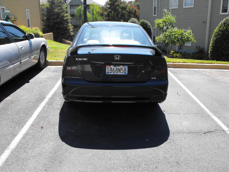

hey all, recently the gf told me to look at her 02 civic. symptoms were her gps falling off the dash and the bumper rattling due to vibration at idle. seems to do this more when the car is warm and idling slow. driving behind her, it vibrates so much at idle the tailpipe moves side to side about 1/4 inch. i have checked all motor/trans mounts, all are tight. no broken rubber, all rubber mounts were replaced in july of '11. (after the $1800 trans guy only tightened the mounts finger tight and all the rubber mounts cracked the 200 miles back home)
trans fluid is good, no leaks no metal in the fluid seems to be mated to the engine just fine and its been fine for about 10,000 miles since the trans was rebult. shifts great, no slipping never stalled and its not showing any codes.
if it helps, i have the elm27 thing and the torque app. i can document anything the torque app can see if needed.
any help is greatly appreciated!
also, just replaced the oil yesterday. no metal or anything of the sort on the magnetic drain plug.
also, i tinted the cars taillights with gila cling on 35% tint awhile back. i think it looks pretty good for something you can return to stock in 30 seconds. finally found a pic on my harddrive and attached it to this post.
thanks again guys!

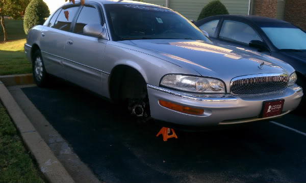

i checked everything visually and with my pry bar when i did the oil the other day. no mounts seemed loose and all the bolts were still tight. (that one above the exhaust is real fun to get at) the light was just the maint reqd light, which i did reset doing the 20 second key on start procedure. she claims she aint ran over anything, and i didnt see any fresh scrapes or damage under there. ill try to remember to take a video tomorrow. was gonna jack it up tonight but the gf had to work late so i didnt get access to it till it was already dark. instead we went to tilted kilt. and the last work done was the oil 3K ago. as for the wheelbearing, it went out because gm used the same sealed hub/bearing on my car as they did the caviler. after driving about 9 hours straight never stopping, it heated up and went. on the highway in the middle of tennessee. which resulted in this.
nothing like spending $130 in tools you already own back home and replacing a hub in a parking lot to make ya remember a vibration like that. lol
