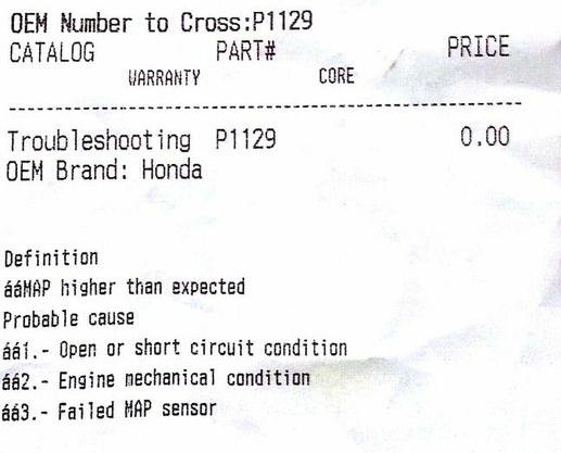

Old Mar 13, 2013
PacosTacos88's Avatar
Joined: Jun 2010
Posts: 127
From: Rapid City, SD
PacosTacos88 is an unknown quantity at this point
Re: Fuel pump?
Originally Posted by ezone
What was the code number?
A code does not automatically mean to replace parts.
A MAP code could be just a symptom, not the cause.
Old Mar 13, 2013
Rep Power: 518
Re: Fuel pump?
P1129, MAP higher than expected.
Fail threshold says 37 kPa (277 mmHg, 11.0 in.Hg) or more for at least 2 seconds.
1) Have you checked for wiring problems? Loose terminals, chewed wires, connector loose at the PCM or between harnesses (in front of the PCM area behind the glovebox)
2) Poor engine running condition;
didn't I already say that could cause a MAP code? (already suggested that it could be a symptom of the problem, not the actual cause of the problem).
3) You already replaced the sensor, let's hope it was a good one.
It would be nice to know what the MAP value displays as on a scanner datalist.
After clearing the code, Does it reset the code again immediately without having to start the engine?

Re: Fuel pump?
Before I replaced it, the Map Sensor came up 4 times after clearing it every time. Now that I replaced it, there's no CEL any more.
