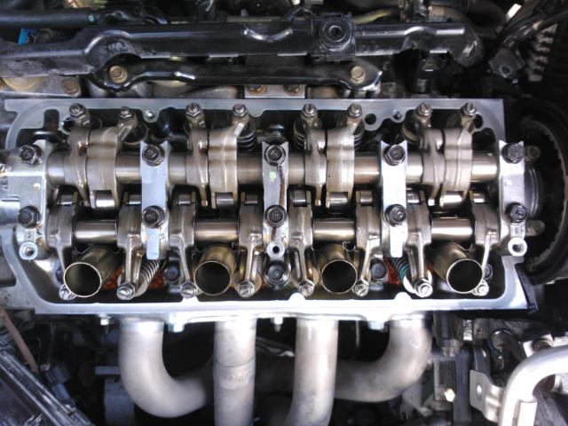

She lives to drive another X amount of miles! Yeah for me.
I did a solid valve adjustment. Went over each set of valves like 4 times and set them all to the exact same spec. .008 on intake and .010 on exhaust. They could be at .007 and .009 depending on how you interrupt "subtle amount of drag". I feel they're closer to the middle based on common sense "subtle amount of drag". I've always heard looser is better than tighter, at least as far as valves are concerned.
Torqued everything that could be torqued and used common sense for the rest.
Did the idle learn first and then burped it on the jack stands.
Changed the oil and filter twice.
Noticeably quieter and feels like it runs noticeably better as well. No leaks and no CEL.

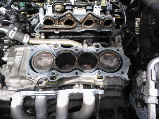

So I have subtle amount of oil weapage in the areas circled below. I'm thinking either the head is warped even though I know for a FACT it didn't over heat or the uncalibrated torque wrench I used didn't tighten it all the way to the final torque. I was think of re-torquing the head to the final 49 ft/lbs spec when the engine is cold. Other than seeing this the car runs better than it has in a LONG time. Oil and coolant level are unaffected so far.
Any thoughts or suggestions would be appreciated.

Just clean it off with some brake parts cleaner.
The MLS gasket can trap oil between layers of steel if you dribbled, and can ooze if you did.
A moist stain isn't necessarily a leak.
See what happens later on after you clean it off a few times.
Make sure you aren't seeing wet carbon/soot or something from the exhaust ports leaking (headers).
Those circled ports are oil returns, there is no real pressurization there. They are open into the crankcase, top to bottom.
If you had a warped head, I'm reasonably sure you would still have a bigger problem with continued bubbling into the cooling system.
Other thoughts, since you mention torque:
Did you suck out/clean out the head bolt holes before you reassembled? Liquid standing in the bottom of the holes will stop the bolts before they can clamp the head down properly on the block. AND fracture the casting due to hydraulic pressure within the hole.
I use a suction pump (fluid extractor), brake cleaner, and an air gun with a long piece of brake line brazed on it.
Did you oil the threads and heads/washers of the head bolts before reassembly? (as per the shop manual) Not lubing also can lower the clamping force at a specific torque value.
HTH
Good information. I really hope it's just trapped oil between the layers. Definitely not carbon/soot from the exhaust ports leaking.
Understand.
Nope. I hope this isn't my fatal mistake.
Fudge....I didn't do this.
Yes I did do this.
I guess time will tell. I'll keep cleaning the area with brake cleaner and see what happens. Fudge.....
Old Oct 23, 2012
  #76
Re: Finally happened to me
If you really didn't, this can cause the head to warp from uneven clamping. The liquid can literally keep the head bolt from going all the way down. You literally torqued against liquid in the hole instead of against the cylinder head.
You could pull each head bolt out one at a time and redo it. Retorque before moving to the next bolt.
Use a long straw and suction gun to pull liquids out of each hole, fab up a long blowgun.
Git bizzy before it is too late.
HTH

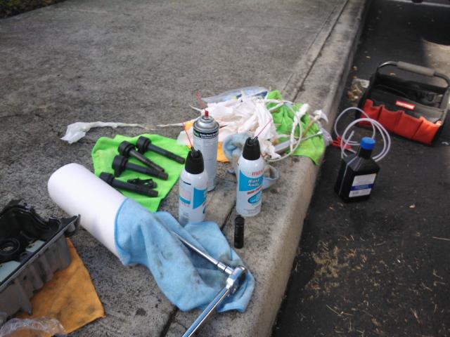

remove one, clean it out, reinstall and torque properly.
Done. I feel better.
My fab cleaning tools.
My 10 year old dirty cylinder head.

Yay.
Looks damn clean in there.
Yay.
I hope it's indicative of how the rest of the engine looks.
Thanks, yet again, for all you're advice and information. I would have just gone and re-torqued the bolts if you hadn't recommended going back in and removing one bolt at a time to clean the holes.
Yay for you.
