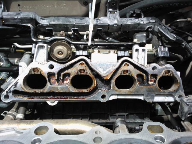

BTW, is there suppose to be oil and soot on the intake area when you remove it?

oh, yeah, i found on mine too, not sure where it came from.

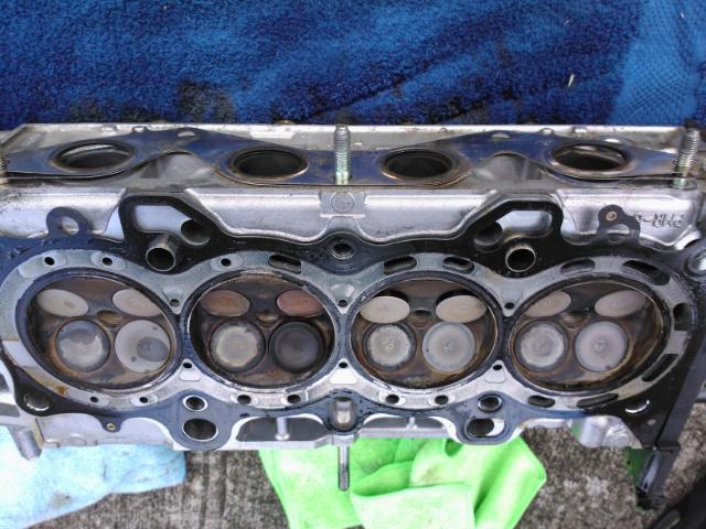

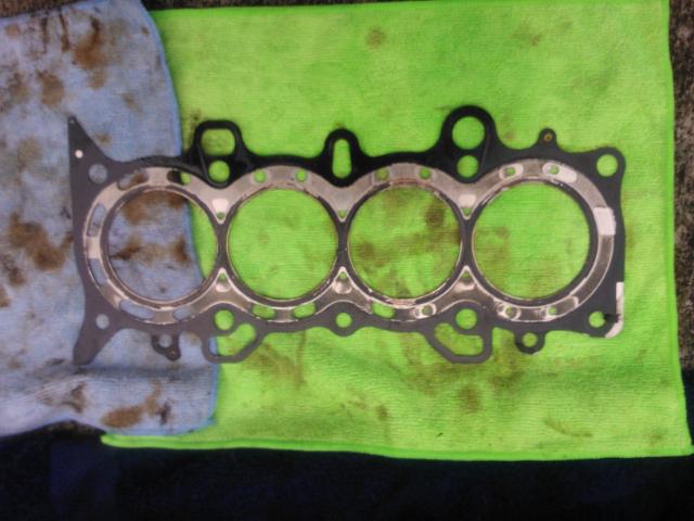

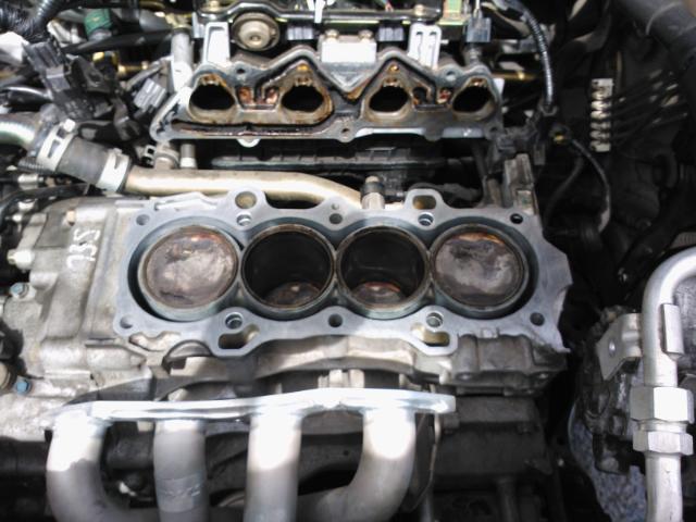

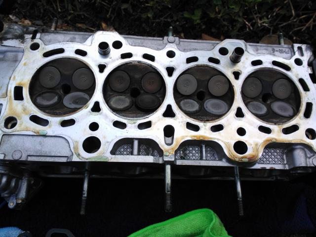

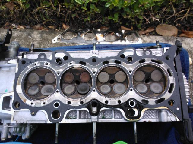

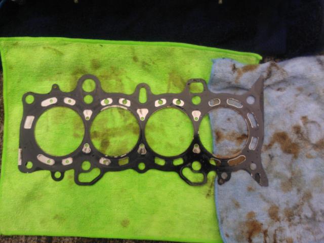

Winner winner chicken dinner! I'm thinking #3 looks a little wet/discolored.
This is straight off the block. Almost no paint stuck on the block or head when I took the HG off.
Size:  67.1 KBName:  WP_000060.jpg
Size:  55.4 KBName:  WP_000062.jpg
Size:  66.7 KBName:  WP_000065.jpg
Head side of HG
Block side of HG
Yes.
Don't lose those 2 dowel tubes! Make sure you KNOW which holes they go in.

Re: Finally happened to me
ezone,
When you've seen overheated heads/blocks, does a lot of the gasket actually stick to the block/head or just some paint?
Old Oct 16, 2012
  #56
You have a MLS (multi-layer steel) head gasket in that engine. The only thing that can possibly stick is the black paint.
Old Oct 16, 2012
  #57
Engines that use a composite gasket: That damn thing sticks everywhere no matter what happened.... unless it hasn't been started yet.
Old Oct 16, 2012
  #58
Matt_75's Avatar
7th Gen Civic DIY Enthusiast!
Joined: Sep 2011
Posts: 784
Likes: 5
From: Honolulu, HI USA
Rep Power: 187
Awesome! Thanks for the info.
I knew I had an MLS, but because of my lack of experience, didn't know if it melted to either service in extreme heat. Sounds like the MLS is much better than a composite gasket no matter how you look at it or are there advantages and disadvantages?
Old Oct 16, 2012
  #59
Ummm...The aluminum would melt long before steel.
However....maybe under certain conditions, flame could burn through the steel gasket, but I'd also expect it to burn the aluminum too. I haven't seen any do this though.
I prefer MLS and I understand many of its advantages over composite, but I'm not the engineer that decides how to build the dang things. I think Honda has them in everything now.....Other manufacturers were using them many years before Honda did.
I think this engine could be a bit more robust if the engineers had spec'd TTY head bolts in it along with the MLS head gasket..
Ummmm...yeah, that was a stupid comment. It should have registered before I typed it but....it didn't. I promise I'm not that stupid, I just have problems typing before I think.
