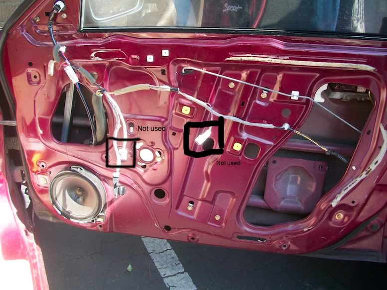

I'd like to ask for some help troubleshooting a power window:
Symptom: Front passenger power window doesn't work (with either switch)
Can someone tell me the next thing to test/troubleshoot?
Or possibilities where the failure might be?
Drivers side power window works
Did the first test: Motor/window works when connected directly to 12V (passenger side)
Bought/installed a new switch on passenger side - Still doesn't work
What's next? The manual doesn't give much troubleshooting steps.
Could there be a problem with the drivers side switch, to make the passenger side window not work?
Is there any reason to reset the "Power Window Control Unit" if 3 windows work?
Is there a chance it could be one of the fuses, if other 3 power windows work?
Here's a picture. Notice there are 2 loose connections, not connected to anything. Is that normal?
I'm wondering if it could be a wire. I bought the car used. Looks like this door has been off before.
Has grey tape on some wires.
It's an 03 Civic LX, 4 door
What would you test next?
What do you think is the next most likely thing to be the problem?
Thank you,
Kevin

Old Apr 27, 2012
Rep Power: 518
Re: Power window troubleshooting
That's a big plus.
*rolls eyes*
A wiring diagram, a test light, and a lot of understanding.
Yes.
No.
Yes. Check #22, 23, 24, 25 in the dash fusebox.
22 is for the RF window motor.
Maybe. Probably for an EX or something you don't have.
Easy enough to prove, no guesses.But I'd doubt that's it.
Big clue is usually the plastic liner has been torn, mutilated, missing, out of place, or the sticky crap is all over the place.
Not a big deal. Could be factory.
In the master switch: Does the button FEEL the least bit different from the rear two? Quite often when they break, they FEEL just a little bit wrong.
I'd be using a test light at the drivers switch to make absolutely certain it is good, or not.
I'd have the proper wiring diagram, and study it so I understand how it all works. Then I'd be testing.
I'd pop the master switch out and leave the wires connected to it. Then backprobe a test light into #1 (blu/red) and #3 (blu/wht) then work the switch and see if the test light lights in both the up and down positions.
Whether the light does or does not light up with that test, determines my next step. Following the wire diagram, of course.
Isn't one of those plugs for the window switch?
The window motor can't work as long as either of the front window switches are unplugged.
HTH
