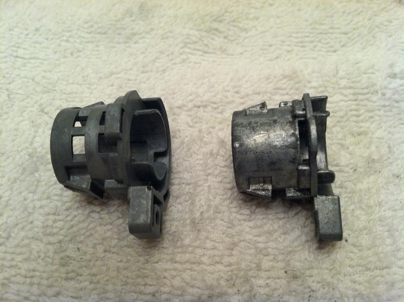

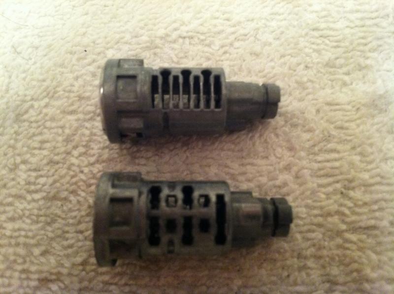

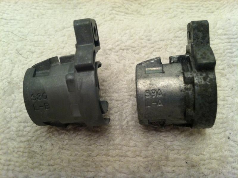

I purchased two door lock cylinder kits P/N 06721-S73-A01 and 06725-S73-A01. One for the driver and passenger side front doors. After my purchase I found service bulletin 03-068 and had no issues removing the old cylinders from the doors. However, this same bulletin list a Door Inner Cylinder P/N 74844-S5A-305.
As I started to reassemble I noticed the new parts don't look the same. The cylinder is keyed differently and the outer housing has a slightly different mold. I tried re-installing the sublock into cavity "A" and it was nearly impossible. I also triple checked to make sure I was using the top side which is solid. I used Honda Parts Now and I'm thinking these are the incorrect P/N's. My key is also thicker than the hinged opening and cannot insert it.
Is P/N 74844-S5A-305 the part I needed? I cannot find any pictures online and don't know what this part even looks like.

If anyone comes across this post save yourself some time and purchase the Honda Genuine Parts from the dealer. The original part numbers listed are incorrect.
The correct door lock cylinder kit part numbers are:
Left Door - 72146-S0X-A51
Right Door - 72145-S0X-A51
Good luck!
