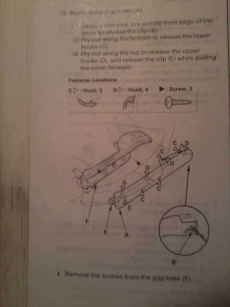

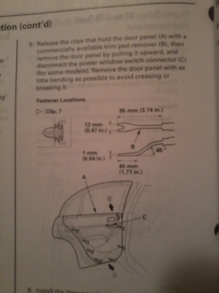

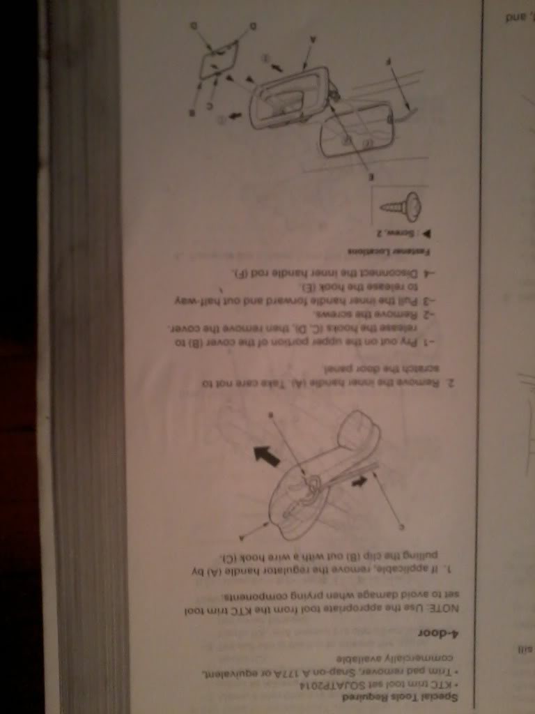

Is it possible you can refer me to a step by step with pictures/video on what to do?
B/c I have never done something like this before and I kinda don't understand what you are saying.
I would appreciate that.
Thanks

Sorry about the fuzzy pics, crappy phone cam. And sorry about the orientation, photobucket is acting up today.
