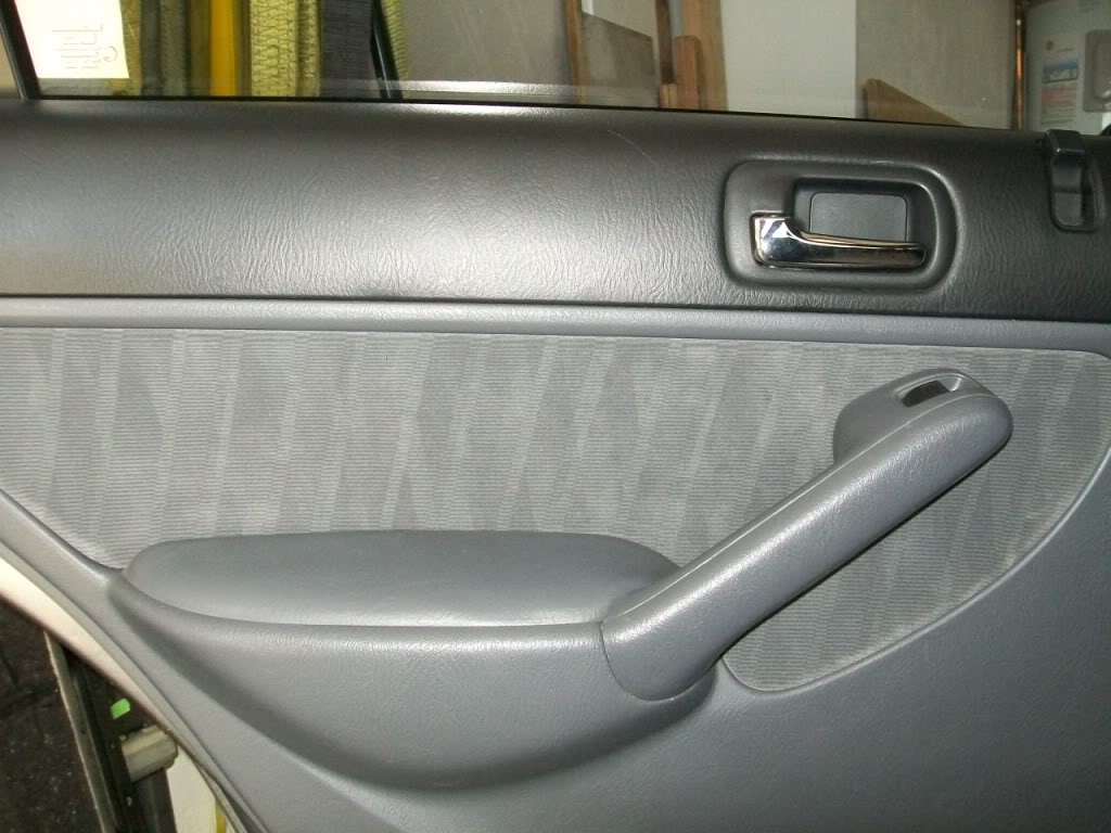

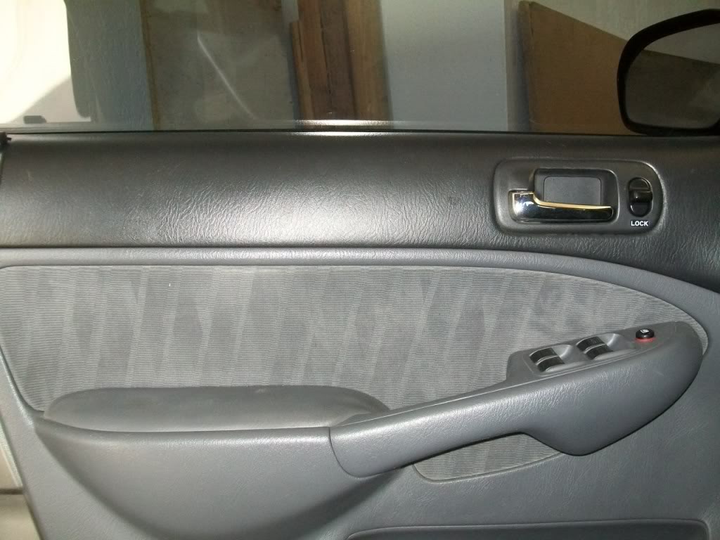

Sorry to post in your thread, but it's a related issue. I've had nothing but problems on the 1999 Civic and the 2005 Civics we've owned (bought both new) with regard to lock actuators. I'm on the 6th to fail out of 8 total.
My question:
I'd like to replace the 3 bad in the 05 Civic, but don't want to damage plastic taking the panels off. Does anyone have a procedure with pics to remove the armrests and pull the panels so I can change the actuators?

Re: Power Lock issue
Wire: A single strand of zip cord from the hardware store or, any length of small stranded wire 18-22 guage would work fine.
Door Panels: Pop cover behind the inside handle (you WILL scratch it) 1 screw. The lower pull handle cover must be released at the [ opening with a small end of an allen wrench then start at the front and peel the cover off to reveal 2 screws. Grab at bottom edge and pop clips around, then lift up.
If you don't mind, I'll shoot some pics and post them tomorrow. If you could, please highlight the lower pull handle cover area I need to start at. Thanks.
If you look underneath of the front of the pull handle lower cover you will see a [ area cut into it near the door fabric. That is where the release is located, once you get it to pop loose near the release you peel the cover off further back.
There are more than 2 screws in the handle but only 2 come out.
Can you highlight the areas I need to access first?
You can see the rectangle panel inside the housing of the inside door handle, it has a notch for a small flat screwdriver for removal.
The pull handles both have a lower cover. Near the front of them, underneath is a notched or cutout area about 1/4-3/8" like --> [ Use a L shaped item to push into the slot and release the front of the lower covers. Work towards back and peel off.
