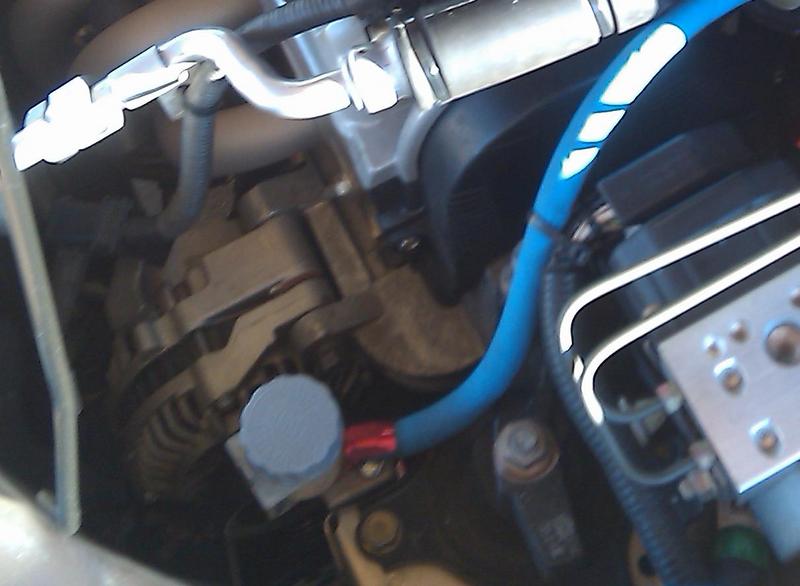

BTW, I think I need to thank you for the P/S Removal DIY. Worked out great!
Name:	Power Steering.jpg

You're the first I've heard that did the PS removal. Glad you like it! I don't think I could ever go back.
