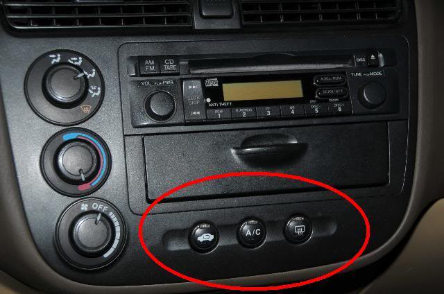

I have a 2003 Civic EX and a few months ago two of the three buttons in my instrument panel stopped lighting up. Each button also has a small light that when pressed lights up to indicate that the button is pressed. The three little lights at the top of the buttons still work when pressed. Here is a picture of the panel:

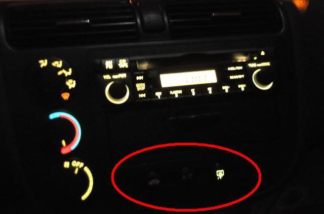

And this is the problem I am experiencing:
It's not a life or death problem but I would like to get it fixed. I hope this is just an instrument panel bulb I can change somewhere. All the fuses under the hood look OK. Any ideas? Thanks in advance.

Neo-Wedge bulbs around 5 in total. I would replace all of them at the same time.

yeah there is one bulb for both those buttons you have burnt out. dealer should carry those.

Pretty much the same as a head unit changeout, 2 screws behind the panel at the bottom of the audio/hvac pod. The pod is tight if it has never been out. IIRC there is a crutchfield sheet I posted on here for the 7th gens.
The bulbs are a plastic base and bulb assembly twist to left for removal using a small flat blade screwdriver.
Get the bulb(s) before starting the job.

i wouldnt use any panel tool. once you remove the two screws from the bottom, you should be able to pull it out by grabbing the whole thing from the top two vents and pulling it out. just rotate the vents so that you get a good grip.
