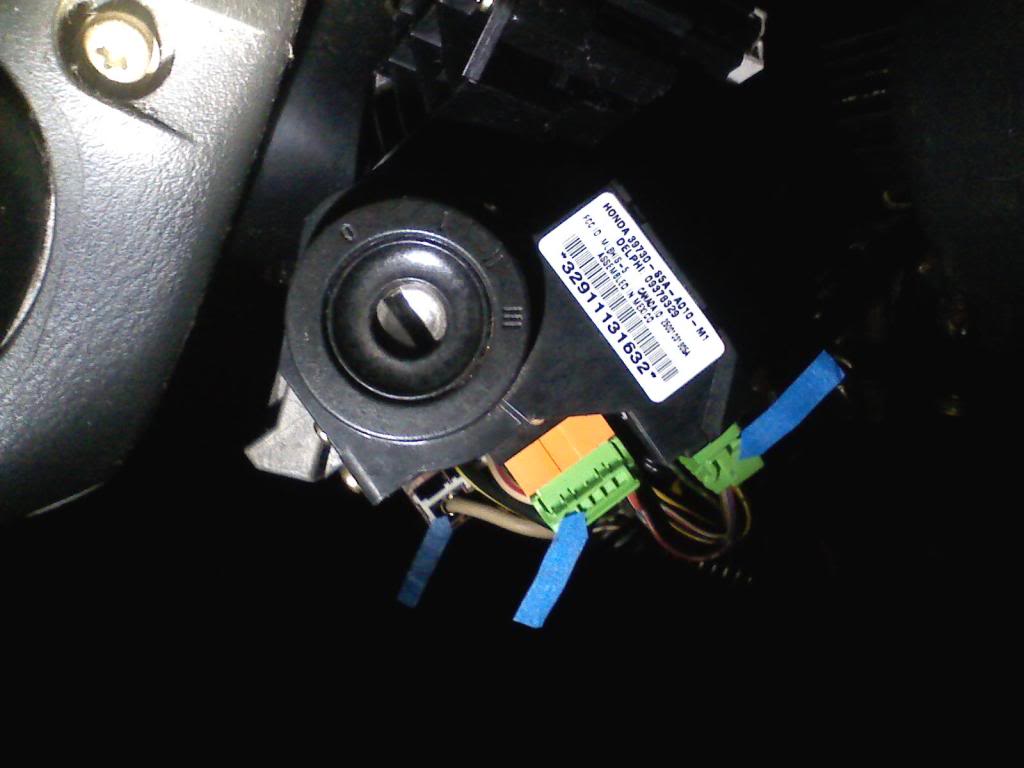

Take the covers off the steering wheel, it's 3 phillips head screws on the bottom. Then check for loose connections or abraded/broken wires.
The arrows point to the connectors. It's one of them, I can't remember which.:
