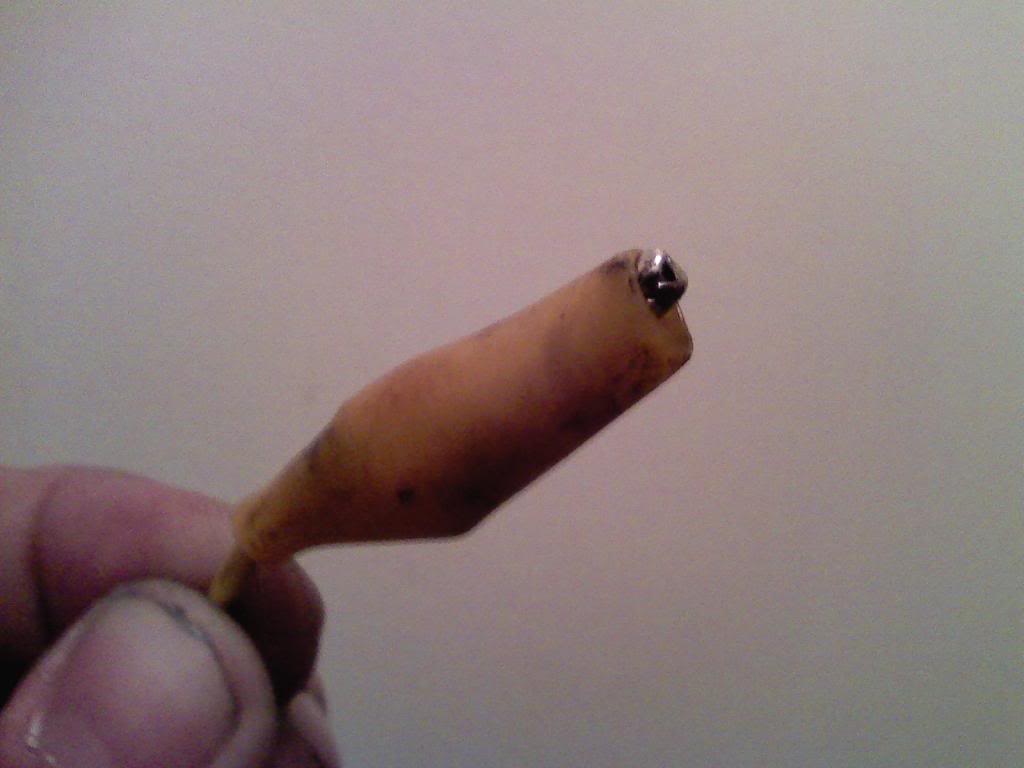

To energize the relay use jumper wires with sheaths on the clips like these:
Also, check the fuses between those two relays again. Don't just look at them, put a test light on them. Sometimes the fuse is bad and you can't tell just by looking at it.
