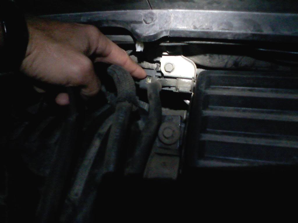

To relieve fuel pressure:
1. Turn ignition to OFF
2. Remove this relay:
It's behind the glove box.
3. Run the engine until it stalls.
4. Turn ignition OFF
5. Remove fuel fill cap
6. Disconnect negative battery cable
7. Disconnect the quick-connect fitting. It's behind the airbox in the engine bay. Here's a pic:
