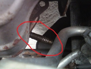

i see this one, but where is the other one?

Oh, and your pic, I'm assuming you're looking down into the engine bay. That would be your pre-cat o2 sensor. Jack up the car and actually locate you cat, and you'll find the post-cat O2 sensor.
