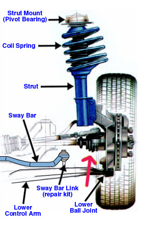

Ok... no prob. Basically CV joints are the ends of your front axles. The axle connects your front tire (front wheel drive) to your transmission. There is one for each side - the CV joint sits in what's called a knuckle the knuckle is right behind your wheel hub. The wheel hub is what your tire is bolted to.
Anywaysssss so that CV joint is right behind your tire all you need to do to check it is look on the backside of the knuckle and you will see a black accordion like cone shaped boot. That is the CV boot, if its cracked you will know it, there will be grease all over the place under there. And if there is grease we know you prob. have dirt in your CV joint - just under that boot. Dirt makes it click and turn to ****. Get it fixed ASAP. The axle will have to pulled off and the boots replaced and the joints repacked with grease.

this pic should help, the pink arrow is pointing the cv boot, the cv joints is under that boot.

Thanks so much for the explanation/picture. I'll check that out tonight and let you know what I find.
