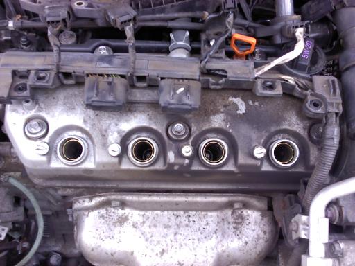

im attaching a picture where it looks like i have some carbon deposit on the vc. Does it look like a header leak??
Any help would be appreciated.

Thats a 04!? Man, you have got to clean the engine down, then you can see what the hell is leaking and what's just dirt. Have you fixed the leak yet? You probably have a cracked hose. Replace the hose or fix the leak, then flush the system not just by removing the drain on the rad. but also there is a coolant drain plug near the oil filter to drain the block. You should also replace the thermo because they're so cheap and easy. Then refill and see what happens.
